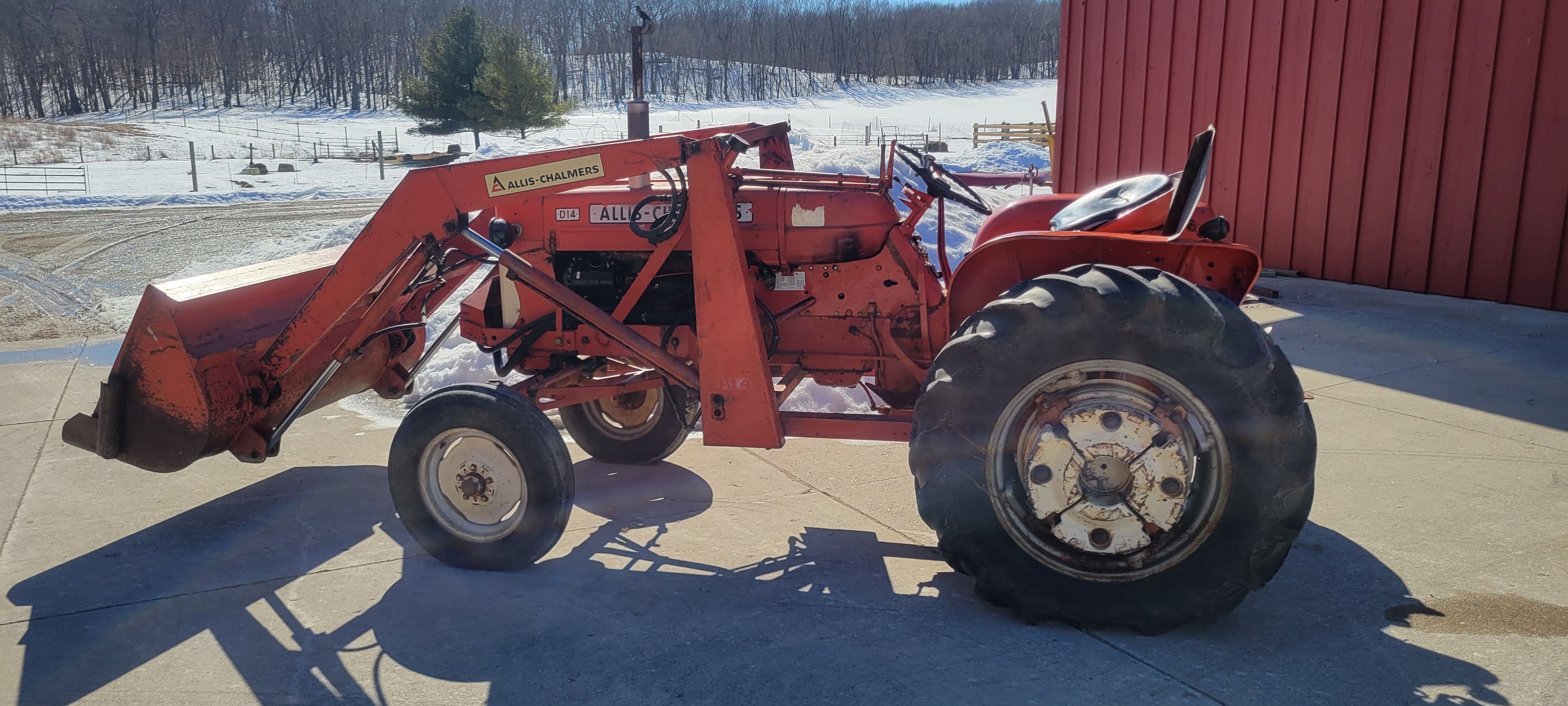

New member hear so please forgive any dumb questions. I know oil discussion is a highly controversial topic, but I just purchased my first tractor  a 1960 AC D14 and while reading through the operators manual my head is spinning as far as what type of oil to use in the different parts of the tractor. Below is a list of what is recommended in the manual. Looking for  opinions on what to run in each as some of these oil are no longer classified/labeled as they were in 1960. Any help would be greatly appreciated!

Not to hijack the thread, but I'm curious as to why the change from 80w in the finals on say a D17 or WD45 to 20W in the finals on the D14 and D15. As to answer part of your questions, hytran oil meating 821xl spec in the hydraulic, power director and power steering systems.For the engine get an oil with higher zinc and phosphorus levels(1100-1200 +ppm) in a 10w/30 weight. You will have to go to a diesel grade or valvoline VR1 to get that level of zinc.The two diesel oils I recommend and use my self are Motorcraft super duty diesel 10w/30 or rotella 10w/30, Motorcraft has a little higher levels.Rotella straight 30w  is now a low zinc oil that should be avoided.Delo 400 and Delvac 1300 are also low zinc as well. Any oil with a SN or later API service rating will be a low zinc oil which you need to avoid. These old flat tappet engines don't tolerate these new automotive oils for very long and will round off cam lobes eventually. That's a nice straight lookin D14 ya got there.Thumbs Up
