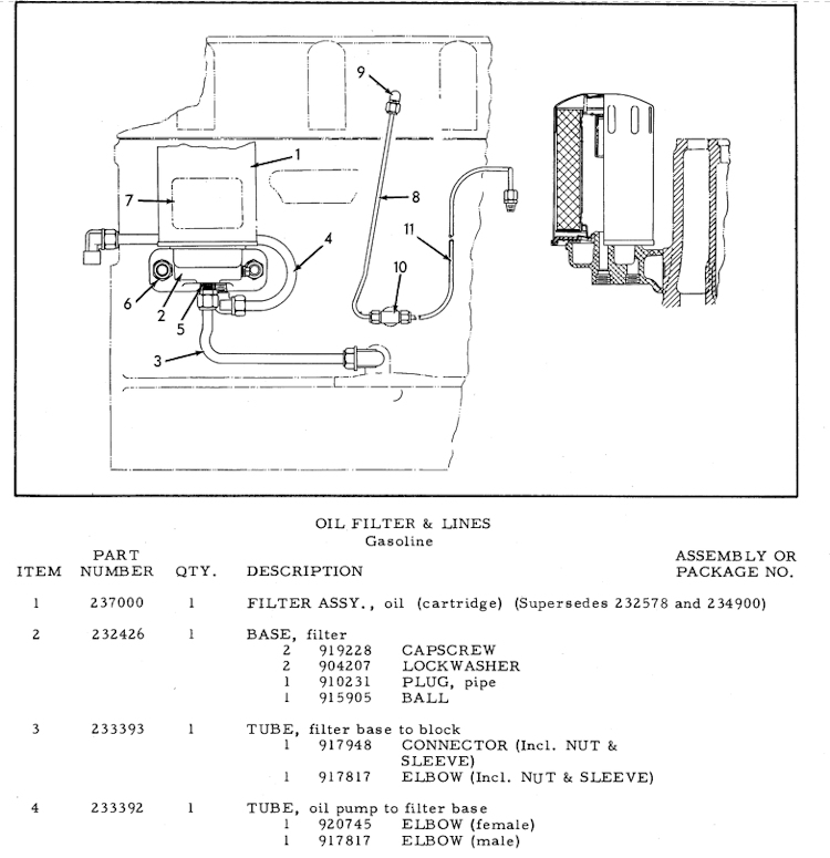

Yes. It is still there and has a steel ball driven into it so it's plugged.

If the drain back hole (in the block) from behind the filter base is open, the ball has been removed, which is what you want for your oiling system.

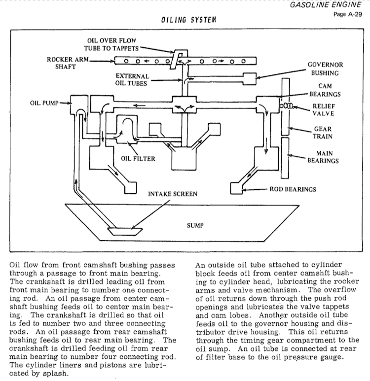

I couldn't find any info on the D14 but I found a manual for the H3 which I believe is the same engine.
Hope this helps

No ball in this block.  Thanks Les for the diagram.  Thanks everybody else for your help and those that called.  I don't feel lucky, I now feel informed!

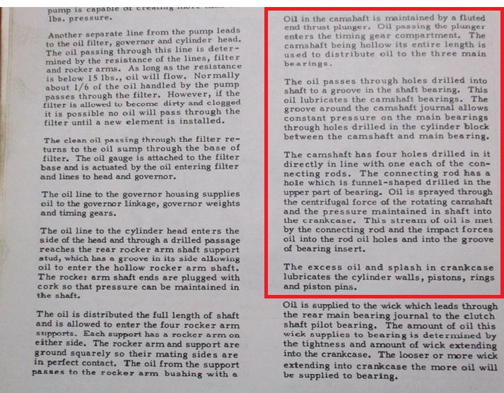

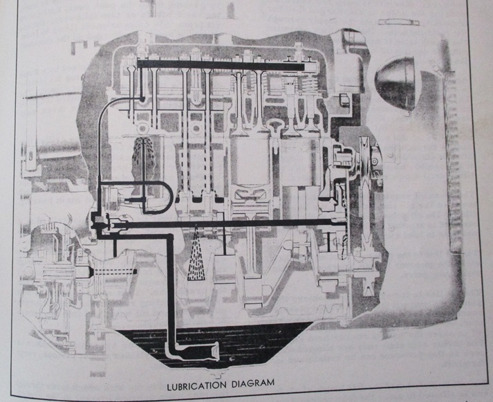

Just to add a little info.. this is from the Original Allis B-C manual
The BYPASS system still has a pressure feed crank shaft main bearings.. The Crank is NOT DRILLED to feed the connecting rods..The hollow cam shaft is full of oil and there are holes in it pointed at the connecting rods that SPRAY oil on to the connecting rod bearings on the crank and wrist pin..

Post Options Post Options   Thanks (0) Thanks(0)   Quote steve(ill) Quote  Post ReplyReply Direct Link To This Post Posted: 8 hours 24 minutes ago at 12:55pm
so.......... the CAM on a BYPASS system should have SPRAY HOLES... and the CRANK on a PRESSURE system should have drilled holes to the conecting rods  ?????????
Points: 22583
Post Options Post Options   Thanks (0) Thanks(0)   Quote DrAllis Quote  Post ReplyReply Direct Link To This Post Posted: 5 hours 34 minutes ago at 3:45pm
B-C-CA-RC engines use the spray oil for the rod bearings. The G-138-149-160 engines are all pressure lube to the rod even tho the oil filter is bypass design. Full-flow oil filtering didn't come til the G-149 in a D-15, not D-14.
