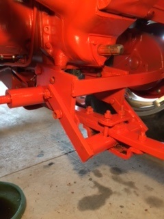

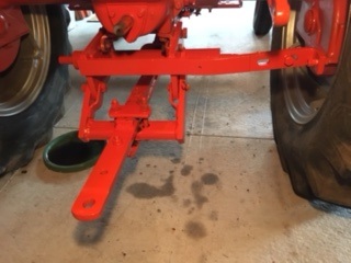

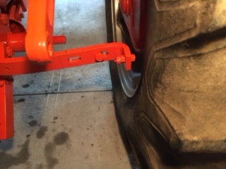

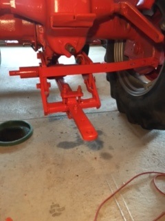

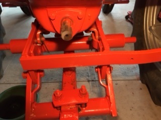

I think I put it back together.  Does this look right?  Feels pretty flimsy.  What is the bar going to the right?  It almost touches the back tire (maybe 2" away).  What does the thicker bar with thinner bars coming out on both sides for (sorry for the technical terms)? The second picture, you can see how the pin is at an angle.  The whole unit is kinda lose.  Is it supposed to be like that?   There is also a bell coupling under the tractor.  I have it put back together.  There is a lever that goes through the right floorboard that pulls a chain to pull a pin to release the draw bar.

You have brackets on the D14 to mount an 80-S mower on the tractor, you don't need the mower mounting bracket on there if you are not mounting the 80-S mower on the tractor.
