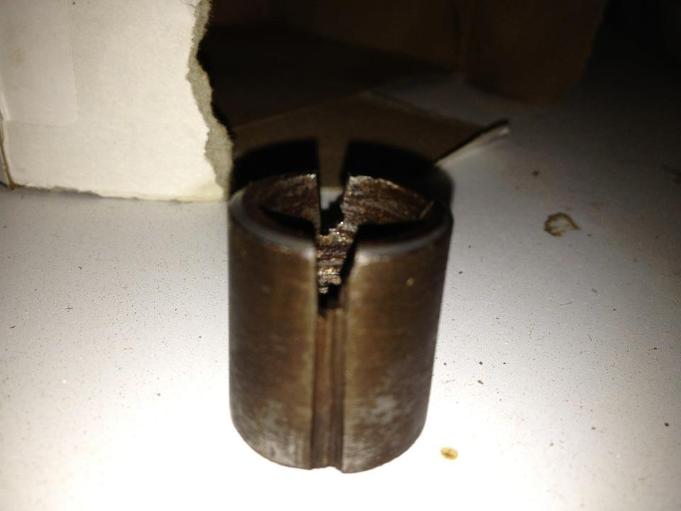

i am overhauling my d14. when i was tearing down this fell out of the camshaft. problem is i dont know when end it came out of or what it is. can anyone help me out???

Post Options Post Options   Thanks (0) Thanks(0)   Quote jaybmiller Quote  Post ReplyReply Direct Link To This Post Posted: 26 Mar 2012 at 6:03am
Well, I can't see anything in the parts book that looks like it ! What are the 'ballpark' dimensions...that might help ...

Post Options Post Options   Thanks (0) Thanks(0)   Quote Chuck(ONT) Quote  Post ReplyReply Direct Link To This Post Posted: 26 Mar 2012 at 6:49am
Looks like it is from the oil pump.

Post Options Post Options   Thanks (0) Thanks(0)   Quote Gary Quote  Post ReplyReply Direct Link To This Post Posted: 26 Mar 2012 at 8:14am
Looks like it might be the coupler from the end of the Oil Pump Shaft.
The Open Ended Slots slip over a pin in the rear of the Camshaft.
DickL will know for sure.
