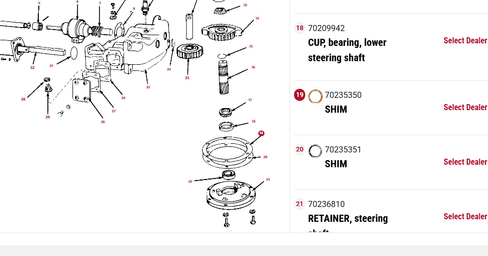

I am replacing the seals and O rings on my power steering cylinder on my 59 D14.  The shims (items 19 and 20 below) for the bottom shaft retainer and small square side cover appear to have paper gaskets between the shims, but the parts manual does not show any sign of them.  On second thought, maybe the shims originally had these gaskets glued to them to begin with?
The shims looks good, but the gaskets are looking pretty tattered.  Do I have to buy new shims that have seals on them?
Thanks for any feedback!

70235350 is a paper shim

Is that also the case for items 26 and 27 for the rack adjusting block?

I just did this project a few weeks ago on my D14. They are a very thin paper gasket, no sealant used. I carefully took mine apart keeping the orientation of all shims(paper and metal) to make sure they went back as they came off. My paper shims were still in good condition. I have no leaks, seams odd not to apply sealant but my IT manual did not mention it and it had none from the factory. SLI said they were available if I needed them. The rack block has them also.
