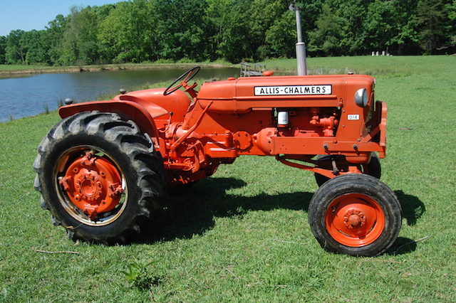

My clutch just started slipping. I opened the inspection cap at bottom of tractor and thought I found a rats nest. Could this have been clutch debrie? I cleaned it out, and everything was dry. I thought the person i bought it from may have been hiding a leak. I was trying to adjust the clutch, but service book I have is not clear. Please explain how to adjust clutch and is it too late if it has started slipping?
