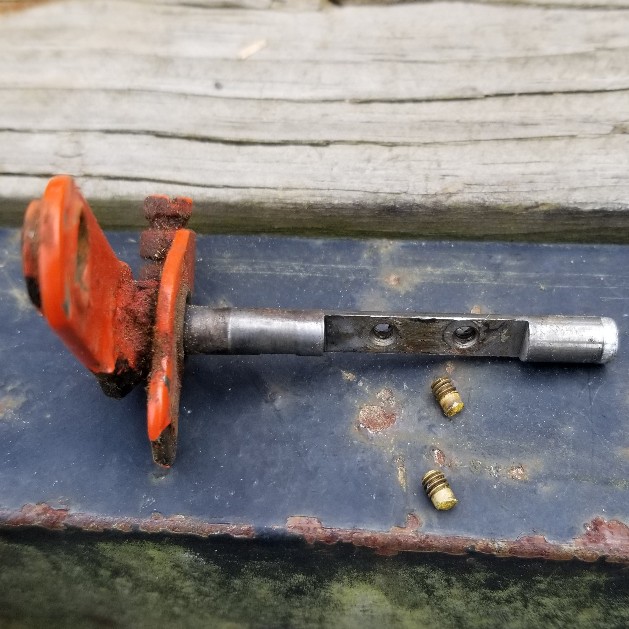

Points: 5276
Post Options Post Options   Thanks (0) Thanks(0)   Quote PaulB Quote  Post ReplyReply Direct Link To This Post Posted: 12 Apr 2018 at 12:10am
The heads of the screws have most likely blown away into oblivion. You may or may not find the butterfly.

Post Options Post Options   Thanks (0) Thanks(0)   Quote Hubert (Ga)engine7 Quote  Post ReplyReply Direct Link To This Post Posted: 11 Apr 2018 at 7:45pm
Pulling the head is a smart move. Try to find the two screw heads while you are in there also. Let us know how far in everything went.

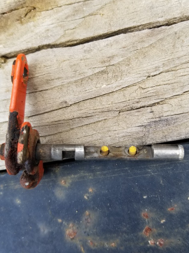

Post Options Post Options   Thanks (0) Thanks(0)   Quote irlbeck A-C'S Quote  Post ReplyReply Direct Link To This Post Posted: 11 Apr 2018 at 7:15pm
When I started the tractor it went full throttle. I shut off the engine. While I was checking linkages I found that the throttle shaft was able to pull out of the side of the carb. This is what I found. The heads of the screws sheared off.
Throtttle plate is gone. I pulled the manifold and could not locate it. Looks like I'll be pulling the head off.
