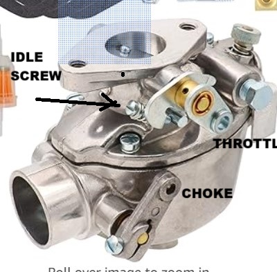

Post Options Post Options   Thanks (0) Thanks(0)   Quote steve(ill) Quote  Post ReplyReply Direct Link To This Post Posted: 19 Apr 2025 at 9:18pm
BAck out the IDLE SCREW and make sure the THROTTLE ARM is down against the STOP to get to IDLE..... not your carb, but something like this.... if you have a mixture screw like the one at the top right of this picture, screw it in to the BOTTOM and back out 1.5 turns...
i have a China Carb on one of my B tractors.. Starts and runs fine... but i had to remove the main jet and make it .002 inch bigger to keep it from hunting at 2/3 throttle.  needed about 10% more gas..
