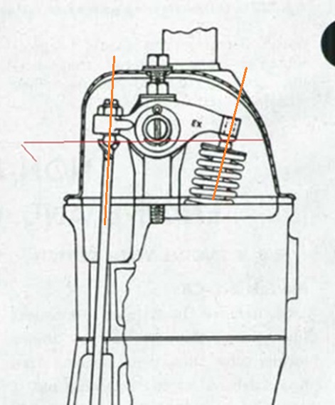

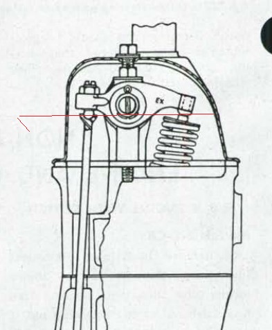

here is a drawing from the "B" service manual.. Shows the rocker arm setting about horizontal.... You should visually be able to tell of your rocker is too far toward the pushrod or too far toward the valve... That would tell you which side the problem is on... assuming your adjusting screws are proper length to have the ball sticking out on the bottom and the nut installed on the top...

look at the drawing above... is the HEIGHT of the PUSH ROD above the head ( valve cover face)  about the same as the height of the valve SPRING above the head  ???
SteveM has a good question ......... about seating the push rods correctly.

again, LOOK at the drawing... If you have room to put the nuts UNDER the rocker, then the adjuster screws must be long enough to fit ?   Unscrew the adjuster and put the nut on the top... Look to see if the PUSH ROD HEIGHT is about the same as the VALVE STEM HEIGHT...... You have to narrow down what you looking at....I doubt the head gasket could be thick enough to cause this... Rocker are TOWERS could have been changed, but WHY ?
Big question is are the push rods and valve stem sticking above the head ABOUT the same  height.... if you look at the drawing.. the adjuster and push rod are PARALLEL on top of each other... also the rocker arm  button is parallel to the valve stem.. neither is at a big angle.. that should also give you an idea of which side ( push rod or valve) is the problem.------- as tbran said, dont put everything i a BIND by getting the angles off..
