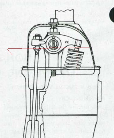

are you saying the adjusting screws MIGHT be the right length, but they are screwed in 1/2 inch too far ?  If that is the case, there should be a LOT OF THE SCREW sticking out of the rocker arm  ??.. If you adjust the screw out so it looks  "like a good location".. can you get the nut on and the pushrods are just  1/4 - 1/2 inch too short ??   Do the valve springs look like the valves are long enough sticking out of the top of the head ?  Valves not compressed too much ?
not an exact science, but the ROCKER should set about perpendicual to the valve stem and the pushrod... just a visual check for "normal" rocker position.

here is a drawing from the "B" service manual.. Shows the rocker arm setting about horizontal.... You should visually be able to tell of your rocker is too far toward the pushrod or too far toward the valve... That would tell you which side the problem is on... assuming your adjusting screws are proper length to have the ball sticking out on the bottom and the nut installed on the top...
Edited by steve(ill) - 8 hours 26 minutes ago at 1:02pm

look at the drawing above... is the HEIGHT of the PUSH ROD above the head ( valve cover face)  about the same as the height of the valve SPRING above the head  ???
SteveM has a good question ......... about seating the push rods correctly.
