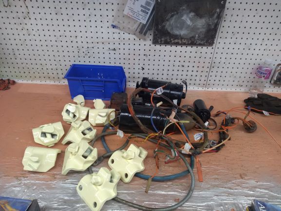

I've got the broken ones soaking in a bucket of penetrating oil.  I decided to just try to get them freed up, put one on each wheel, and use a hammer and chisel to lock them in place when I reassemble.  It's just a parade tractor, so I doubt I will ever have to get them off again.
Regarding my color concerns, this tractor was definitely never PO #2.  I'm wondering if it got caught up in the transition when Allis switched the paint color.  I'm still going to paint it #2 and Cream, since that is what the Swinford book says it should have been, and maybe even moreso because I have a whole bunch of PO #2 sitting on the shelf.

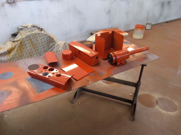

Post Options Post Options   Thanks (0) Thanks(0)   Quote bincitybandit Quote  Post ReplyReply Direct Link To This Post Posted: 21 Dec 2019 at 12:02pm
Hope to get some primer & paint on after Christmas..........

Points: 8560
Post Options Post Options   Thanks (0) Thanks(0)   Quote Sugarmaker Quote  Post ReplyReply Direct Link To This Post Posted: 21 Dec 2019 at 12:27pm
bincity,
Your going to have a very nice looking tractor! Looks like professional paint booth??
Thanks for posting the pictures! I think it helps get all of us excited about seeing these come back to life with new parts and new paint!
Yous shop looks great! That rear and front rubber looks almost new!

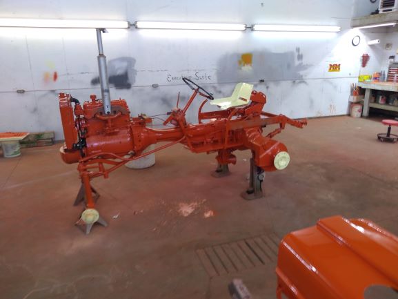

Post Options Post Options   Thanks (0) Thanks(0)   Quote bincitybandit Quote  Post ReplyReply Direct Link To This Post Posted: 25 Jan 2020 at 5:03pm
Got the primer on right after New Year's.  Used an epoxy primer, and didn't care for it all.  Won't be using it again!

Post Options Post Options   Thanks (0) Thanks(0)   Quote bincitybandit Quote  Post ReplyReply Direct Link To This Post Posted: 25 Jan 2020 at 5:06pm
Put the color on a week ago.........
Started re-assembly a couple nights ago.  Hope to have it finished up by the end of next week.
Just got my new grille from Pfouts Family Farm, and it looks great!  Just need to put some color on that next.
The end is in sight!
