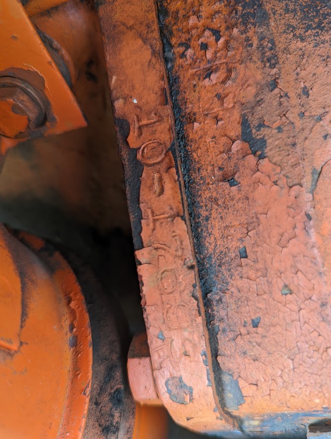

Hi all!  I am attempting to identify my D-12 to match parts and what not.  I am having difficulty making out the serial numbers, and wanted to see if anyone here could make them out, offer ideas of how to better read, or offer enough info to get some basic info!  See images attached:

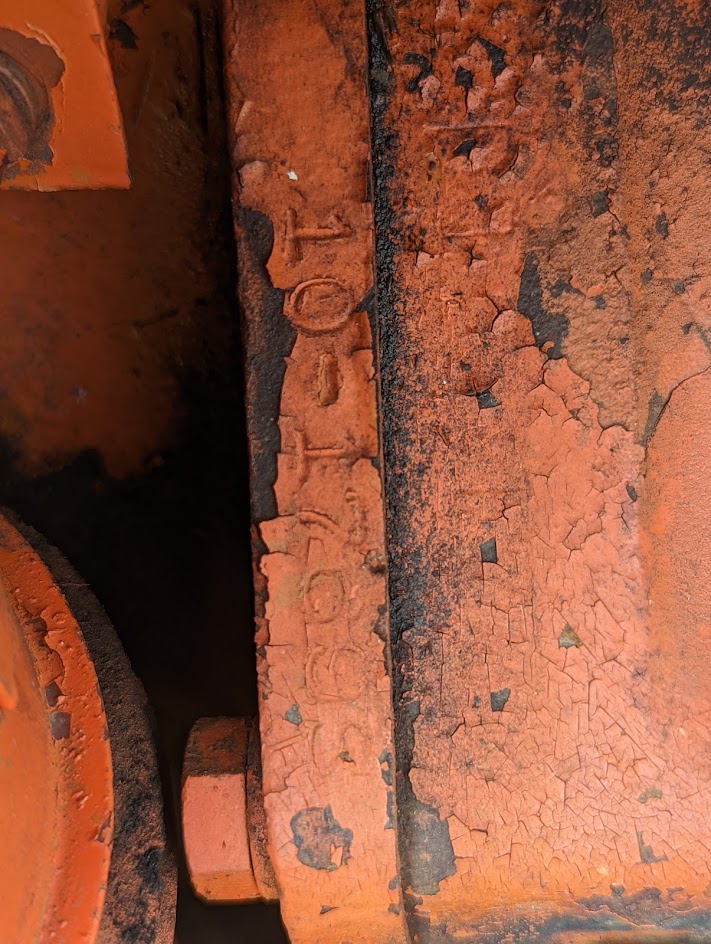

Here's another at a slightly different angle

Post Options Post Options   Thanks (0) Thanks(0)   Quote steve(ill) Quote  Post ReplyReply Direct Link To This Post Posted: 20 Apr 2022 at 12:23pm
D10 or D12 ? ......... serial numbers and years are not far apart...
Points: 90793
Post Options Post Options   Thanks (0) Thanks(0)   Quote steve(ill) Quote  Post ReplyReply Direct Link To This Post Posted: 20 Apr 2022 at 12:24pm
Im guessing since it starts in 10 - 17xx ......... that it is a 1959 series  I  ,  D10 ?
Edited by steve(ill) - 20 Apr 2022 at 4:53pm
TramwayGuy View Drop Down
Joined: 19 Jan 2010
Location: Northern NY
Points: 11857
Post Options Post Options   Thanks (0) Thanks(0)   Quote TramwayGuy Quote  Post ReplyReply Direct Link To This Post Posted: 20 Apr 2022 at 2:45pm
That last figure on the Serial looks like an ‘S’; not a ‘9’.   A special order, maybe?
‘D10-1769S’.   A 1959 D10.
Richardmo View Drop Down
Location: Rolla mo.
Points: 1747
Post Options Post Options   Thanks (0) Thanks(0)   Quote Richardmo Quote  Post ReplyReply Direct Link To This Post Posted: 20 Apr 2022 at 3:55pm
Clean the other part off of the torque tube it has a serial # on it is right by the engine serial #.
The last letter is a S pretty common on the engine #.
juniorp53 View Drop Down
Joined: 16 Mar 2012
Location: United States
Points: 53
Post Options Post Options   Thanks (0) Thanks(0)   Quote juniorp53 Quote  Post ReplyReply Direct Link To This Post Posted: 20 Apr 2022 at 4:00pm
i am not a d series expert but isnt the number on the left the engine# and the number on the right the tractor#
wire brush and some brake clean will get the crud off so you can read it ...wire wheel on a grinder would be even better
Points: 5276
Post Options Post Options   Thanks (0) Thanks(0)   Quote PaulB Quote  Post ReplyReply Direct Link To This Post Posted: 20 Apr 2022 at 6:20pm
As you have a engine starting with 10 it is most likely and early model, unless the engine has been swapped. Clean the area on the torque tube to read the tractor serial number better. I do see 12 at the beginning of the tractor serial number, the rest hidden.
cgraffeo View Drop Down
Joined: 18 Mar 2022
Location: New York
Points: 24
Post Options Post Options   Thanks (0) Thanks(0)   Quote cgraffeo Quote  Post ReplyReply Direct Link To This Post Posted: 21 Apr 2022 at 7:22am
Yeah, from what I've seen, the D-10 and 12 are the same except for a wider adjustment on the D-12.  I'll use a wire brush in a hope to knock some of that crap off tonight and see if I can't get a better photo.  Just to be clear though, the "Torque tube" is the section on the right in the photos correct?
For reference, the left of the photo is towards the tractor body, the right of the photo is towards the front of the tractor.  Everything I've seen says that the numbers are "on the left" but this is found on the "passenger" side of the tractor so to speak, which to me would be on the right side of the tractor.  Is "on the left" if you are on the tractor looking forward or if you are looking at the front of the tractor?
Are there any other locations for these numbers other than where the engine meets the body as shown above?
Thanks
Edited by cgraffeo - 21 Apr 2022 at 7:26am
Calvin Schmidt View Drop Down
Location: Ontario Can.
Points: 4583
Post Options Post Options   Thanks (0) Thanks(0)   Quote Calvin Schmidt Quote  Post ReplyReply Direct Link To This Post Posted: 21 Apr 2022 at 7:48am
The serial number you have shown is on the engine. 10- xxx means that it is a 138 cu.in engine. People get confused because this engine could be in a D-10 or D-12. The tractor serial number is on the torque tube just behind it.
Points: 90793
Post Options Post Options   Thanks (0) Thanks(0)   Quote steve(ill) Quote  Post ReplyReply Direct Link To This Post Posted: 21 Apr 2022 at 8:41am
Chris, i think your looking at the photo wrong... your motor is on the left and the torque tube is on the right.. You can see the air cleaner in the photo far left... This is the "drivers" side or LEFT side of the tractor... As the guys said, clean the paint BEHIND the 10- 17xx number to find the D12  xxxx  tractor number.
