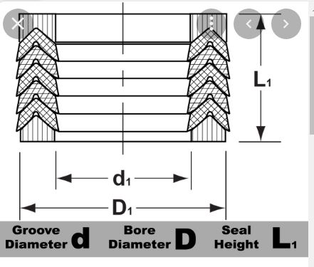

Nat im not 100% sure what cylinders you are working on, but you said you tried to TIGHTEN the nut, so i assume it is a CHEVRON or SQUARE Packing set..... there may be an oil seal on the outside edge that is a WIPER to keep dirt from getting inside... That is not the seal..... There have been a couple guys recently buy After Market Chevron sets and rebuild the rear lift cylinders of the D series tractors.. Maybe they will chime in here...
All you need to know is the ID and OD and how many rings you want...pull the rod out of the cylinder and see if it looks like this.
https://www.sealsales.com/packing/vpacking.html
