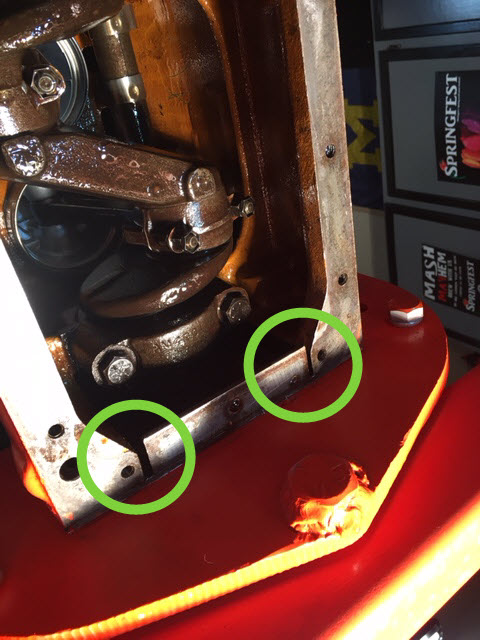

Guys, I have removed the oil pan and have a new gasket and I am going to clean it all up and re-install it. The pic below shows two areas that were gooped up with some type of flexible sealant. I took that stuff out when cleaning everything up and now I have to re-apply something in those areas because they are big gaps that will definitely leak oil.
Questions are:
1. Is laying a really thick wad of sealant in those areas a correct method?
2. What type of sealant should I use for this?
3. When I put my new gasket (cork) on should I use that same sealant on both sides of the gasket?
Thanks guys :)
Jeff

I'm getting ready to replace oil pan gasket on 1963 D-15.  I want to see your replies to this same procedure.  I saw one method of putting thin coat of silicon to hold gasket in place to block with bolts in to keep it from shifting while it firms up.  Then use vaseline on the outside of the gasket for the pan to go against.  Lightly tighten up bolts to around 5 lbs. torque.  Not sure if this is correct way, but I do see some logic there.
Mark
