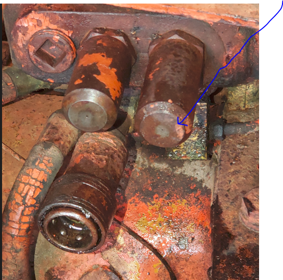

My D10 finally runs:
Now onto hydraulics. I am getting a leak from the hydraulic valve body, pin hole.
I was wondering if the pin hole is really necessary? Can it be sealed? I am betting this part is still unobtanium. I would like to fix it correctly.
My luck is I blew a hose so the cylinders and lines are getting replaced.

Jon, your second and third links need help.

I couldn't link the thread for some reason.

It may have been covered in one the the posts you linked, but there are o-rings on the spools that will need to be replaced.

Are there any instructions out there on how to do this and I am assuming parts just have to be matched up?

Did anyone ever start making these? Tracy
