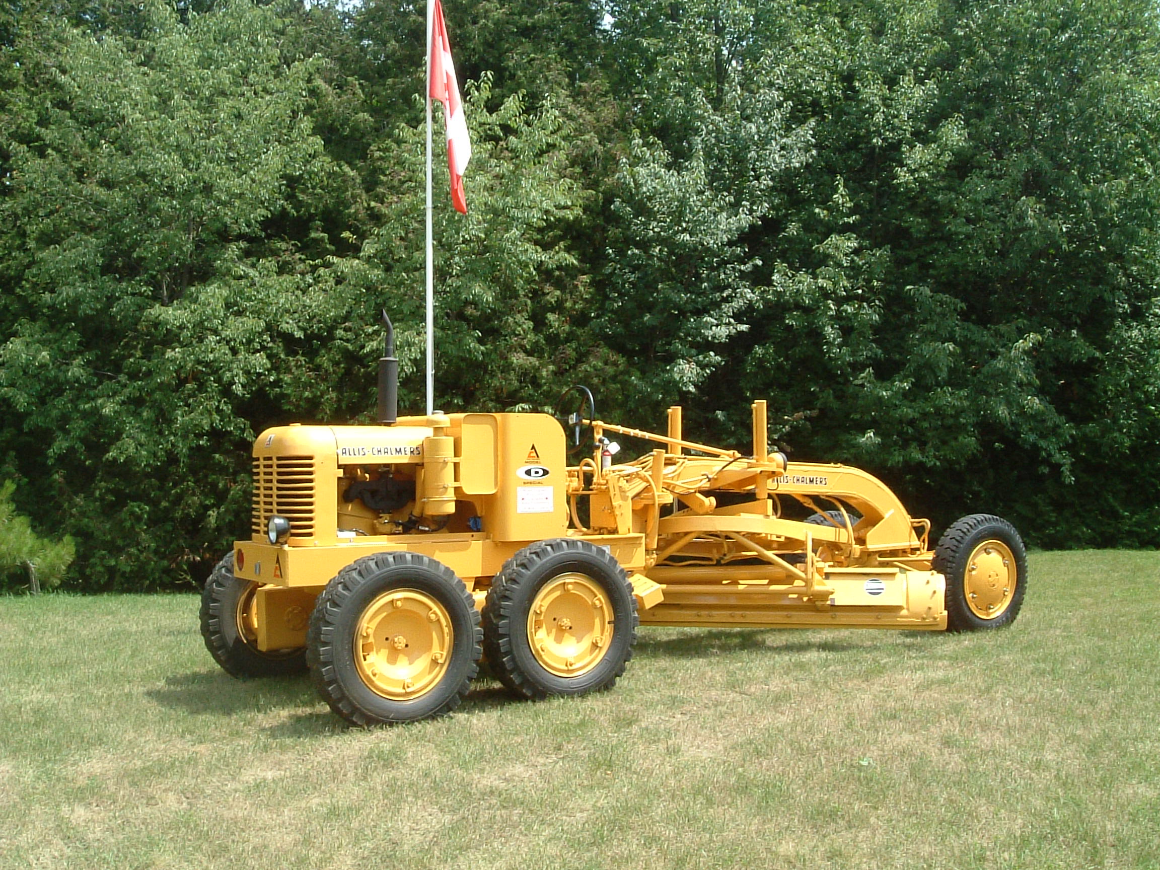

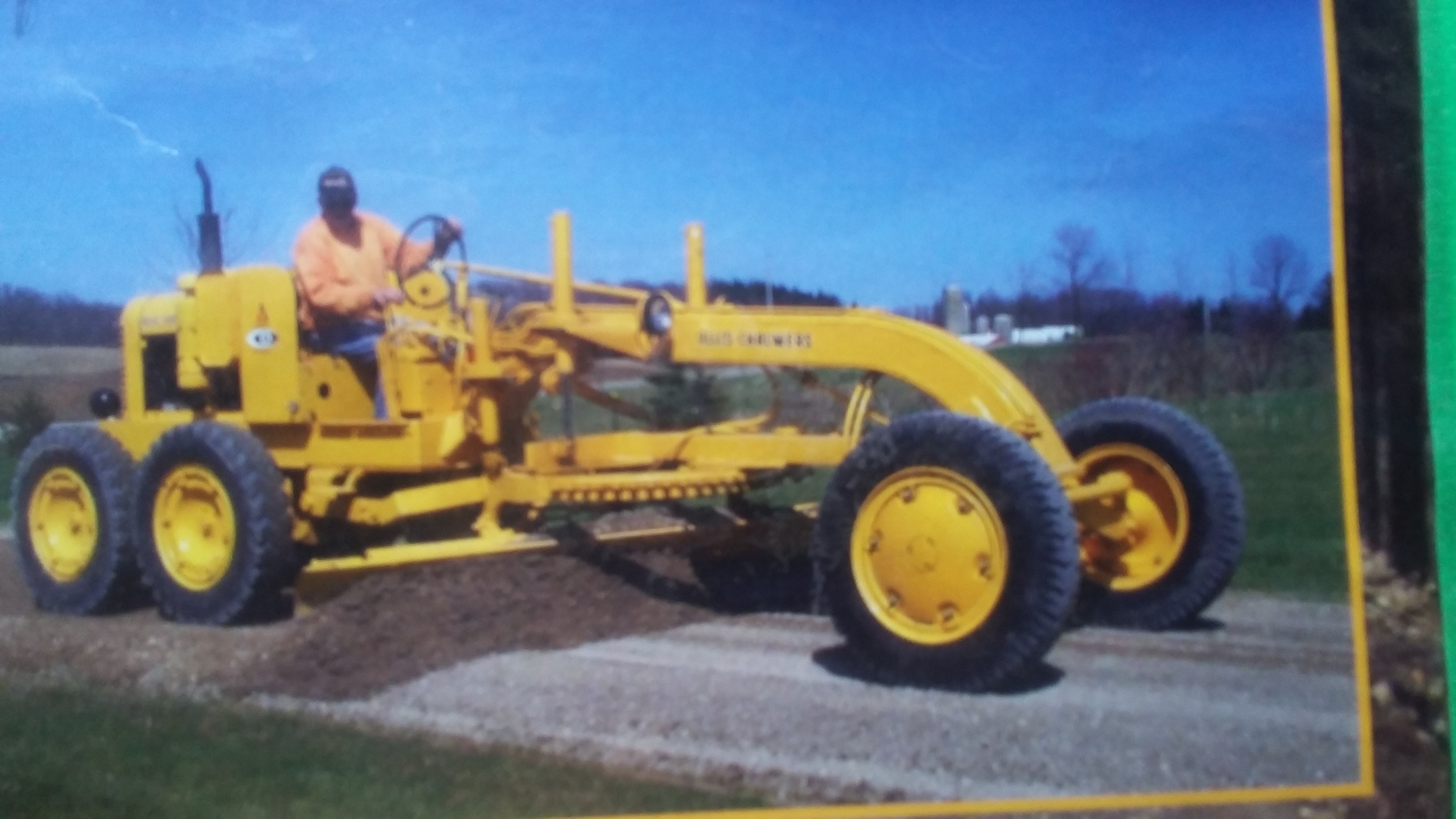

   My grader is a 1967 'D Special'. It came with all the extras, except power steering. Here are pictures. The first picture is with Calvin Schmidt grading a country laneway. The second picture is a laneway grading of a friends 1/2 mi long farm driveway.   Ross D.
