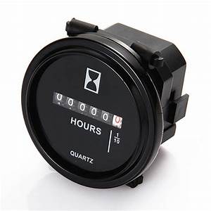

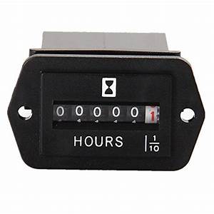

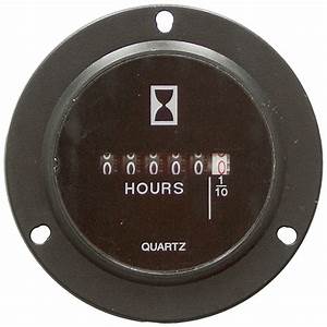

If you aren't looking for a finished restoration quality tractor and want to track operating hours, use an electric hour meter. They are common on a lot of equipment to track operating hours. Power through an oil pressure switch if you want to be sure a key left on doesn't run the hours up. Mount it on a bracket under the hood if you don't want it to show.

Thanks for the replies . Jim , that electric hour meter would work . I just wonder when this tractor was serviced when it was new and earning its keep ? Maybe annually ? Thanks again
