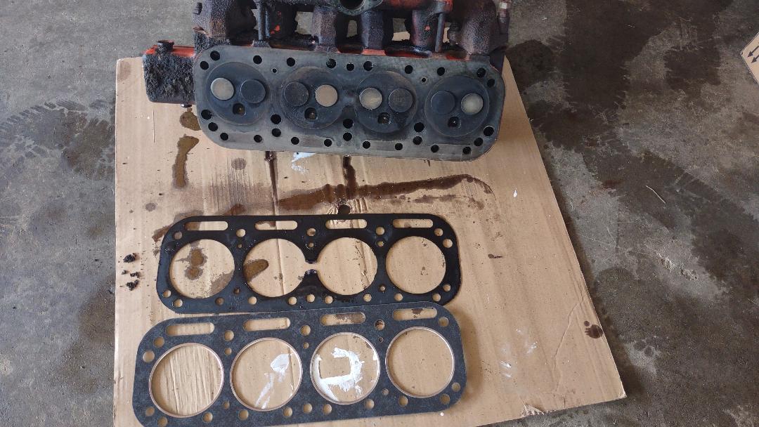

I have a D-15 II that I bought at the end of May 2025. It had a skip. When I did a compression check, #2 and #3 were down considerably on compression compared to #1 and #4. Here's what i found when I removed the head.

Post Options Post Options   Thanks (0) Thanks(0)   Quote steve(ill) Quote  Post ReplyReply Direct Link To This Post Posted: 10 Dec 2025 at 5:41pm
since #2 and #3 are 180 degrees apart, you would think if the head gasket was blown, youi would have zero compression on both cylinders ?? ... when one cylinder is on COMPRESSION, the exhaust valve is open on the other cylinder..

Post Options Post Options   Thanks (0) Thanks(0)   Quote WF owner Quote  Post ReplyReply Direct Link To This Post Posted: 10 Dec 2025 at 5:57pm
It was a while back, but I believe I had about 60 psi on 2 & 3 and close to 150 on 1 & 4.
