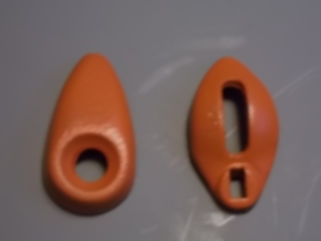

i now have the repop mount casting and the light.
The casting mount has a round (about 1/4 inch) stud in the casting with no threads on the rear of it.
My fender has the front hole for the carriage bolt and a smaller hole behind it for what I assume would be the power wire.
Question is should i grind the stud off of the mount or bore a hole in the fender for it to drop in.  Boring the hole would be kind of by guess and by golly.
I am thinking of grinding the stud off and relying on the front carriage bolt to hold things in place.
What do you think, or what is the answer on the mounting?

Dave, the fender should have 3 holes to accommodate the casting.  Here is the order starting from the front of the tractor:  1) Carriage Bolt, 2) oval slot to adjust the angle of the light, 3) the stud.
The stud is important and should not be ground off as it keeps the mounting from moving around.  If anything, make sure your fender has a hole for it.  If it doesn't, it would be quite easy to drill one.  FYI, the power wire goes through the stud of the light and does not have its own designated hole in the fender.

Myron, wow thanks for the reply and information.
Something is wrong with my fender.  All those holes you described make total sense.
Now since I am in the dark, I am wondering if I got a fender for the series 1, I understand that they had the little running light on the fender.  That may explain why the slotted mount is on the rear of the seat.
Now I m thinking that instead of getting the drill out, next spring i could fill and repaint that left fender and put the work light on the mount on the rear of the seat.
I don't know, I will probably wind up drilling the fender.  Most likely scenario since i got the wiring harness for the series II.  Confused

Dave, the holes in your fender are correct. There was a small red bullet tail light mounted there. The work light was dealer installed. I think mine is on the right fender. Bob
