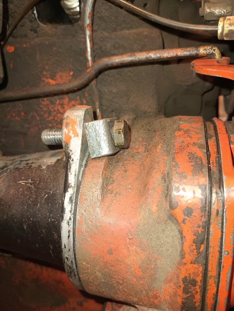

Double checking myself and the distributor clamp doesn't look quite right. Anyone know how it goes? Hope to have pictures up soon. This is the clamp on the horizontal piece between the distributor and the governor.Thanks

That's it Steve. Right under the governor stop. Kinda hard to see in your picture but it looks like mine is wrong. Thanks

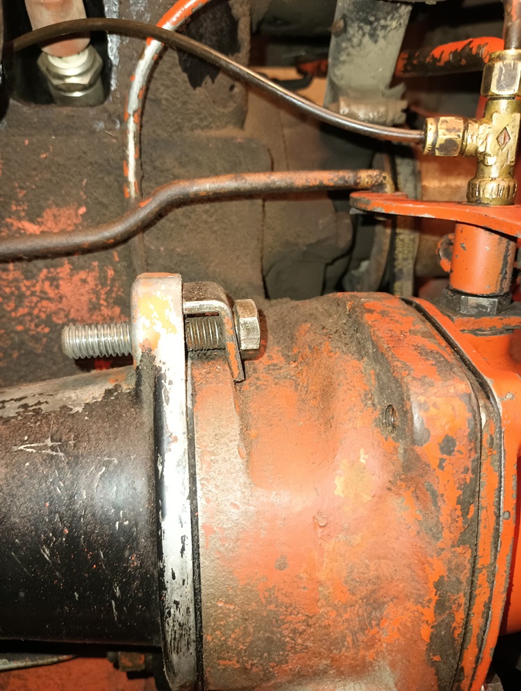

rotate the foot part UP... so it sets on the distributor flange and the forms an "L" bracket , similar to my photo..... my photo looks cast, yours is sheet metal, but they should do the same thing.
Points: 90616
Post Options Post Options   Thanks (0) Thanks(0)   Quote steve(ill) Quote  Post ReplyReply Direct Link To This Post Posted: 18 Dec 2025 at 7:59am
not a real good photo, but the EAR goes on top and points back at the distrib.
the clamp is just a PINCH fit... if the EAR is too short, youi might have to put the clamp in a vice and bend it back to 90 degrees or a little more so the leg touches the flange... when you tightne the nut it PINCHES down

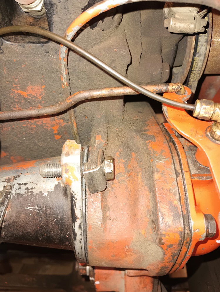

Post Options Post Options   Thanks (0) Thanks(0)   Quote ACinSC Quote  Post ReplyReply Direct Link To This Post Posted: 18 Dec 2025 at 11:44am
That looks better. Thanks again Steve
