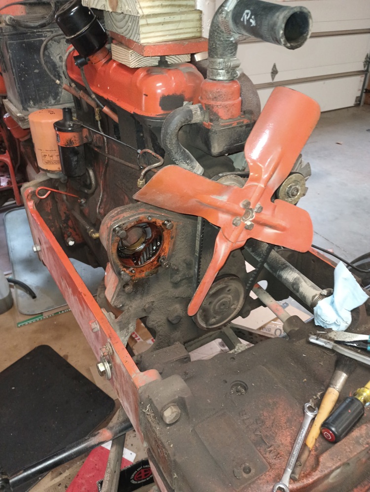

Pulling the disc and the engine over revved. Throttle lever also moves on its own. Have tractor in my little shop now. Pulled dist yesterday, gov shaft has a lot of play. Book says remove rad next,then gov. Anything else I need to do while I'm in there? Thanks

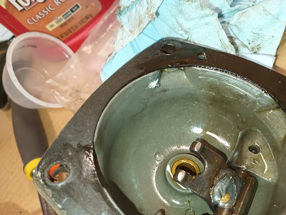

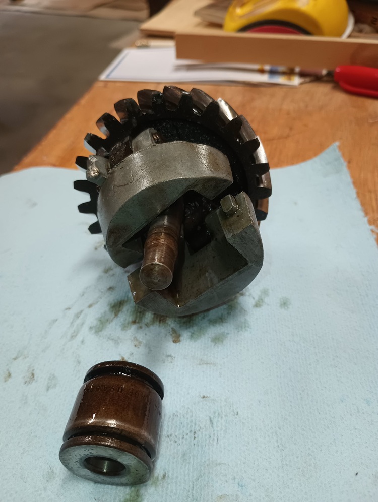

Have the gov off. Ears? on the weights have been hitting the inside of the housing. Guess something is missing or broken ? I'll try to get some pics posted. Thanks
Edited by ACinSC - 01 Dec 2025 at 3:03pm

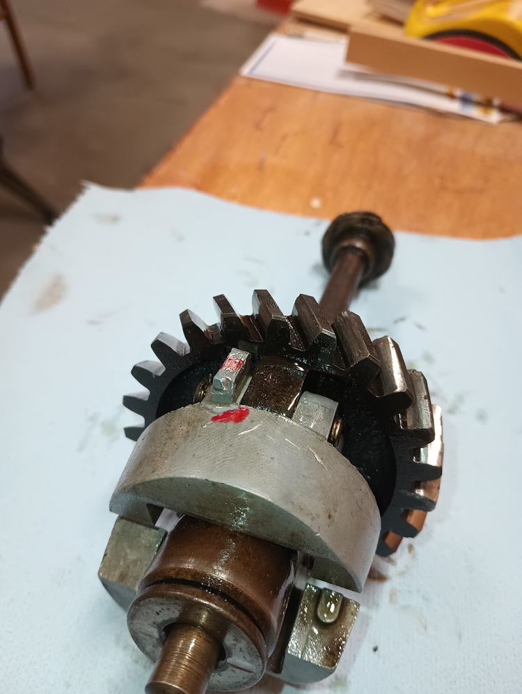

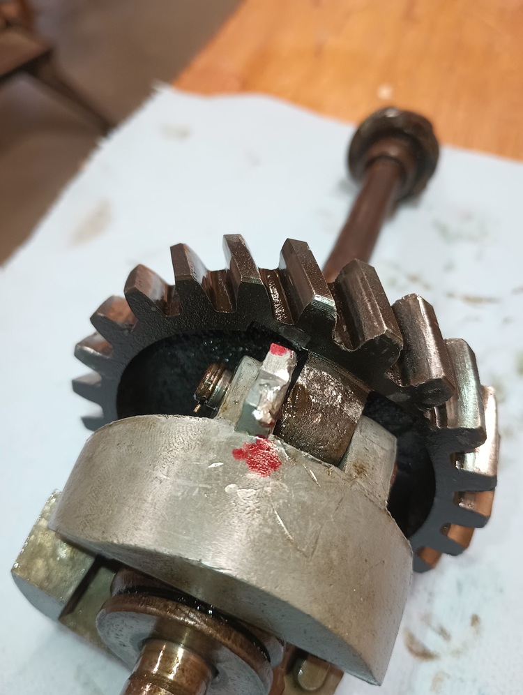

Now I see the weights have a inside ear? that keeps it from hitting the inside of the housing. One of mine is missing. Wonder where it is? Bottom of the oil pan would be good . Thanks

No sign of the governor weight piece. May drain the oil and see if it's in the pan. Thanks
Points: 8971
Post Options Post Options   Thanks (0) Thanks(0)   Quote SteveM C/IL Quote  Post ReplyReply Direct Link To This Post Posted: 07 Dec 2025 at 1:45pm
If it's not visible in or around gear train i wouldn't worry about it. It can do no harm in the pan. Likely hood that it ever makes it to drain hole is slim too. It's not magnetic so fishing for it not happening.

Have my old D 15 running again
Have 2 old dwell meters. One reads 30 and one 32 . Set the timing by ear. When I get some help I'll check it with my light.WOT is a little shy of 2200 .Thanks for the help guys!
