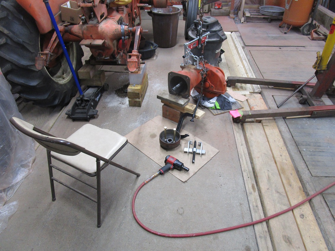

Jay you were right, I just hadn't noticed there are different part numbers for the left or right side. I have a pretty good lip inside the drum from wear. So with help we got the drum off. I'll be taking it to the machine shop to have it turned down.
