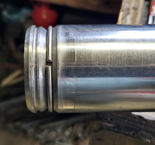

This may help anyone who's trying to get a cylinder apart for resealing. They are all over Gleaners and some Allis tractors. Instructions are to go through oil port with screw driver and pry snap ring over to deep groove. I struggled by trying to wedge screw driver in groove near end and twist it to move ring. Could not do it. Finally I just pryed against the ring and it moved over easily starting at the end. It is rather simple when done right but was kicking my butt for quite awhile. I think it will be just as easy going back together if I reverse procedure. Thing is,I've done this before and don't remember have such a time....but it's been a few yrs.

Assembly didn't go well. Took 8lb sledge to "tap" it through the seal and then I managed to push the snap ring over the groove into the cylinder. Had to tie both ends to the cherry picker to pull ram past the seal,of course destroying the lip. Call this a "do over".

... Instructions are to go through oil port with screw driver and pry snap ring over to deep groove...
Hmmm... I have a pair of cylinders on an old loader that I can't figure out how to get apart, I wonder if this may be the trick?
To clarify, I just need to extend the cylinder, remove the hose fitting, and look through the port hole, possibly rotating the rod to access the end of the snap ring?

Probably from either port if its double acting. Single acting combine header lift cylinders only have one port

I see a little problem with the cylinder rod in your picture. After many times of the rod hitting the end of the stroke the snap ring will roll up a small edge that needs to be filed down and smoothed so it does not cut the seal on the way in. Sometimes this makes the rod difficult to remove.
