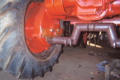

My son found the pictures of my customized B with the seat, steering wheel, and pedals moved forward.

That looks neat! Have a photo of the rear showing the 3pt setup?
Makes me think of what an "unstyled" D10 would look like. Lol

Started with a 500 hundred pile junk .Tractor was togather.Fenders were rusted off at bottom,hood been shot through,grill all bent up,every thing else in bad shape.Had every piece apart except tran and diff.Radiator was good.Retired and needed a project and 2300 dollars  and a year and half later it looked different.Later made cult.All my ideas and all my work  no thing from anyone else except i thought of D 10. NOT FOR SALE

I am wfmurray's son. I found a few more photos of his customized B. I'll post more later today, but here's a couple to start.

More pictures!  Doing a conversion like this is a fun exercise in problem solving...
Please show us how you did :
Seat relocation
Pedal linkages
PTO linkage
Steering shaft shortening/relocation,
That groovie 3 point (is it closer to the rear tire ground contact point?  if so, it has greater lift capacity before needing weight on the nose!)
Fabulous Fabrication of Fenders, and nice toolbox!

I'm a purist, but WOW!! That is one awesome B! Love the quality fabrication work! The 3pt hitch setup looks like it could be factory! Everything is just fabulous! It's a shame you're so far away...I'd love to see it at Hutch, and I'm sure most others would as well!
If I had a CA with those same modifications, I might just ditch the 8N...
