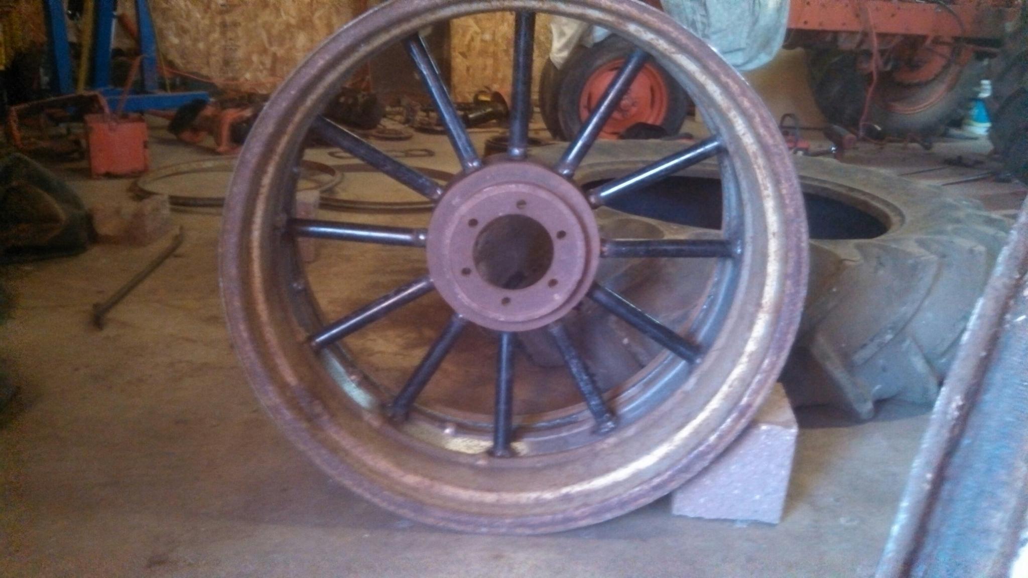

this is one of the spoked wheels I welded up to fit my 16.9x34 tires on my wc. They are a little heavier then what I wanted but thinking they are going to look dang good when I am done!

nice what do they weigh

Just a guess but I'm going to say 80-100#

I weighed mine last night they weighed 85# they are 14-38

I'll have to throw them on a scale and I'll let you know. I just hope they are not over 125

My rims are 16x34 and I used the cast centers from old F&H spokes

Thanks! I thought about making a set like you built but my buddy talked me into building these. Plus I like the look of spoked wheels on old tractors.

What size tubing did you use for the spokes?

1 5/16" diameter with 3/16" wall thickness, schedule 80 tubing
