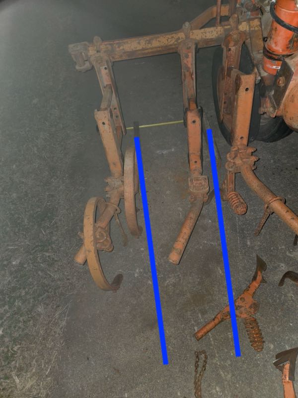

Okay, a couple of years of thinking later, I am back at this. I plan on putting in a few acres of beans this year.
I started laying out parts for the front gangs on one of my CAs today. There are 4 gangs on the standard 2 row cultivator. I was measuring and my crazy idea is to attach 6 gangs on the front. On one side, the inner two gang bars are shoved all the way to the inside (as close to the engine as they will slide on the side frames/gang mounting bars). Then the 3rd gang would go wherever needed to get shanks down on the other side of the outer row you are cultivating. Repeat for the opposite side of the tractor and you're covering 4 rows.
This would be more weight for the lift mechanism to raise, but I have a manual for the CA toolbar cultivator and I can't imagine it weighs any less than 6 of the "2-row" cultivator gangs. The lift apparently handled the toolbar version okay.
I will lose ground clearance because I am not keeping the gang bars on either side of the row (I believe this is probably where the 28" minimum row spacing specified in the manual comes from). I will only have about 12" of clearance as the gang bars pass over top of the plants vs. closer to 22" of ground clearance with the intended setup, and I won't be able to use the factory shields.
I have 11.2" rear tires. I can swap a WFE over in place of the narrow front I currently have to take the dual wheeled NFE width out of the equation, if needed. That leaves the rear tires as being my constraint for row spacing. 15" would be great but too tight after the beans leaf out much. I may end up around 18-20" and hopefully leave myself some room to cultivate later into the season if needed. The fields will have plenty of foxtail and some Johnsongrass to deal with.
If you made it through reading that book please shoot holes in my idea. I am new to cultivating with the CA and am trying to think of anything that might keep it from working with such narrow rows... Before I set my planter row spacing and commit.
wjohn View Drop Down
Joined: 19 Jan 2010
Location: KS
Points: 2622
Post Options Post Options   Thanks (0) Thanks(0)   Quote wjohn Quote  Post ReplyReply Direct Link To This Post Posted: 10 Feb 2026 at 10:53pm
It is a little tight at the middle two gang bars but I think I can make 18-20" rows work. The perspective is a little wonky due to the angle of the picture. I need to rob some more of the spring trip shanks from a different cultivator to replace those C shanks on the outside, and also flip some of the shanks to the other side of the gang bars and position them as required.
Edited by wjohn - 10 Feb 2026 at 10:54pm
