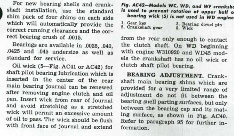

if you have the crank out, its a striaght shot thru the crank.. you can use a small drill to help get the old one out..even if you dont have the crank out, a small drill can help get it out from the rear..... YES.. its a pain putting the new one in.. rolling it on a table top to get it a few thousandths smaller than the hole can help.. book aint much help..

Soak the wick in oil for a couple of days, Tie a piece of mig welding wire (or other small strong wire) around one end and then with a lot of strength pull the wire and wick thru and trim excess.
  Or plug the hole in the crank and put a dub of grease in the pilot bearing before mating the engine and bellhousing.

It says "or no clutch shaft pilot brg". ....What keeps things in line?
There are some serial number breaks in the WD/WD45 parts catalog that seem to indicate they used one for a while, then didn't use one at all for a while, and then put a bearing back in but changed to a different part number. My WD had an unsealed/unshielded open ball bearing (I presume so the wick oil could easily get into it) and I replaced it with a sealed/permanently lubricated bearing, removed the wick, and plugged the hole in the crank. I think I heard about doing that somewhere on here.
