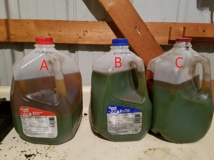

On the tractor that was running rough, I noticed that there were leaks at all 6 air manifold and both coolant manifold connections to the head.  I took both manifolds off in an attempt to investigate the problem.  When I drained the coolant (because you can't stop at just taking manifolds off your first antique tractor), I found something weird that I am hoping one of you has seen.
Bottle A was the first gallon (give or take) to come out of the radiator, bottle B was the 2nd gallon to come out of the radiator, and bottle C was drained out of the block.  When I drained the oil it was jet black so I know there was no water or coolant in it, but I can't figure out what is up with the coolant.  Has anyone seen this before?
I have two hypothesis:
1.  Two different types of coolant were used and didn't mix and have therefore stayed as a layered liquid.
2.  There is oil or some other foreign substance mixing into the coolant that should cause me concern.
Can anyone help?
Edited by MN-Realtor-Farmer - 16 Dec 2016 at 12:57am

congrats on your new to you tractors, and welcome to the forum! all my tractors (cept one special one) are all newer than yours so I can't comment on what might be in those jugs like that (I don't know the answer), but there will be lots of others that can/will help you on this! and if'n you gits lots of snow....you can thank me later! lol

Might be oil in them jugs so that might mean a head gasket. I would be conservative and do a compression test to see if one cylinder is down on compression and causing it to run rough. If one was low the that would point to getting into the engine more. If all cylinders were about the same then I would do a tune up, change the fluids and run it some to see if the problem persists or not.

Normal if it had been setting. Drain plugs are at bottom where all foreign matter settles. MACM

If "oily", could also be an additive from years ago as does not take much for residue to show up and separate. Years ago additives like Marvel were considered standard with a lot of the older units as the thought process was it reduced corrosion. I remember as a kid where a cup of marvel was standard in the radiators back in the northeast.

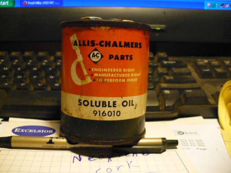

I remember A-C sold "soluble oil" to add to the radiator fluid, as I recall it mixed with the coolant and became milky.  It was considered a preventative.  I don't think it would settle out, but maybe it did when the tractor sat.

Like Tim says, old timers put a little oil in the coolant. That's an old practice that's no longer necessary/shouldn't be done anymore because of coolant technology. If the oil were coming from the crankcase it would be just as black as what you drained out of the oil pan. No matter which way you go, discard it properly. To remove oil from a cooling system if you're not overhauling it, Simple Green is very effective.

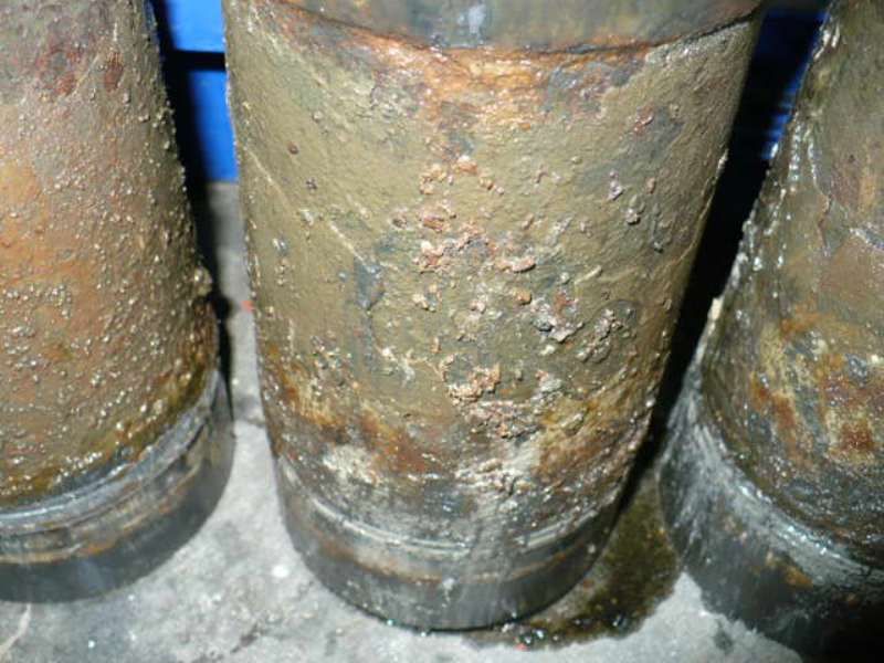

You mean like this stuff?
Don(MO) View Drop Down
Location: Bates City MO.
Points: 6862
Post Options Post Options   Thanks (0) Thanks(0)   Quote Don(MO) Quote  Post ReplyReply Direct Link To This Post Posted: 16 Dec 2016 at 2:28pm
When you find the coolant that looks like that then the inside of the engine might look like this.

Welcome to the forum. I don't have alot to add except that I would be in the camp of checking compression and getting the ruff running one going even if she limps a little to plow right now. Take the other one completely apart and go through the motor or better yet wait for one of the wd 45 to get there and if neither one runs better rebuild one of them they have a little more power. But as long as the compression test looks ok I would do plugs wires points condenser cap rotor and if she still runs ruff get a carb cleaning. Electrical is all easy and probably the biggest problem you have with it not running well or would be my first guess. If you can get her out there at all you will have a much happier wife. And this life...lol   besides the way shameless is going you don't want to shove it all...
You said the motor oil looked black without antifreeze so I wouldn't worry about cross contamination if that was the case you would find a mix in both places or expect to anyway.

You learn something new everyday. I never knew there was such a thing as soluble oil to mix with antifreeze.

Welcome to the sight. When oil and water are in the same container the water always settles to the bottom. Like when water gets in theoil you loosen the drain plug a the water will come out before the oil.

The oil is probably black because it hasn't been changed for several years. Like others have said, get it running good if possible, check everything out and change the fluids. You'll get a good idea of what you have that way. By the way, welcome to the forum and before you know it you'll be helping others.

It seems like the consensus is that the oil was put there on purpose, and that the coolant should simply be replaced.  I would love to flush the system out before spending money on 3 new gallons of coolant, but alas the temps won't be above freezing here for many months.  Any tips for flushing the system out that doesn't require a hose and a heated garage with a drain?
Both of the WD's are torn down to the block, the stuck one so that I could see what I was dealing with, and the rough running one because I got carried away.  The head off of the stuck one seemed to be in better shape (less carbon on the valves, valve stems, and valve seats) so I am probably going to throw that one back on the rough runner and limp her through until warm weather allows me to do everything right.  That will also allow me a chance to soak the other tractor's valves and head in some Berryman's Chem Dip and try to get that one cleaned up.

the correct name for the water soluble oil is called DROMUB-B.we used it in all the big radial aircraft engines that had water injection.it was a lub,for the water injection pump and the water regulators.you only had to use 1 pint for 50 gallons of water.....

that should have read,dromus-b for the oil
