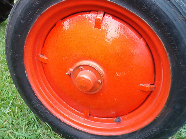

The B has the cast front wheel centers. Can anyone give me an idea what year it is from that clue? It does have an electric starter and somewhere in it's life has been converted to 12 volt because it has a Delco alternator.

if your looking at a photo and the front wheels appear to be CAST.. you could be looking at wheel weights ?? ... If the wheels are really CAST, that should narrow it down to 1938 - 39 era ...... Being that these tractors are 70- 80 years old, a lot of them are a mix / match of years.... the alternator conversion tells you nothing..
You need the serial number on the trans case, and the engine number on the left side by the flywheel housing to give you any idea of the year.. VERY EARLY engine numbers were on the top rear of the bloock behind the #4 cylinder.
