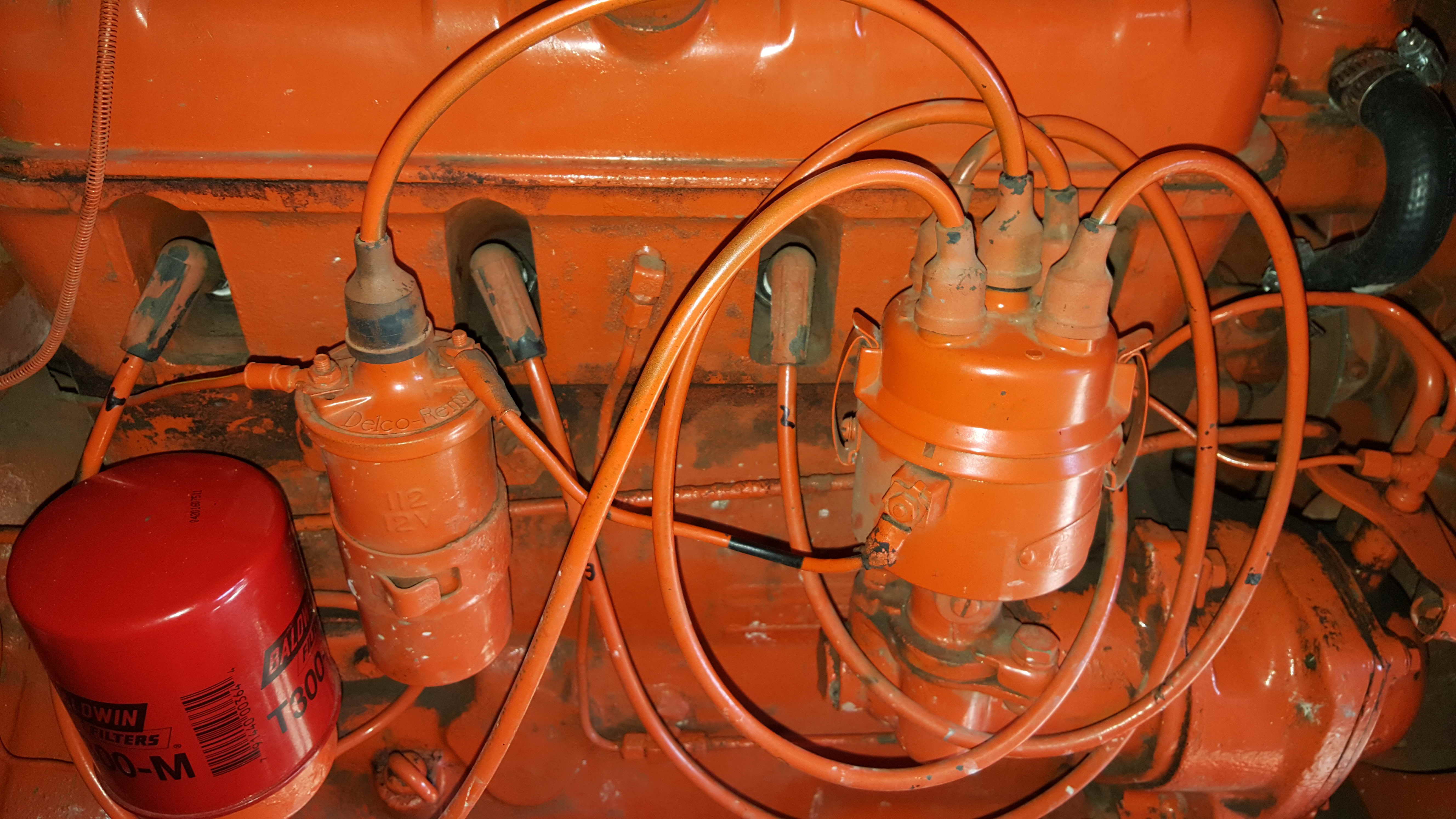

Post Options Post Options   Thanks (0) Thanks(0)   Quote brews4me Quote  Post ReplyReply Direct Link To This Post Posted: 15 Nov 2016 at 11:13am
Folks-
Everything is pretty much original, new 6 volt battery with 3 cells.
6 volt system with generator.
BUT, someone along the way (recently) installed some 12 volt coil (probably the the incorrect one and off some old junk car maybe??? but it does run) and a inline fuel filter.
The coil is marked 12V
Edited by brews4me - 15 Nov 2016 at 11:21am
brews4me View Drop Down
Joined: 24 Jun 2013
Location: Aguilar, CO
Points: 37
Post Options Post Options   Thanks (0) Thanks(0)   Quote brews4me Quote  Post ReplyReply Direct Link To This Post Posted: 15 Nov 2016 at 2:52pm
Sorry, don't know why the picture showed up as giant size???
Can anyone tell me if that's a Delco Distributer????? I am not close to that tractor since I closed up the barn for winter.
Dan73 View Drop Down
Joined: 04 Jun 2015
Location: United States
Points: 6054
Post Options Post Options   Thanks (0) Thanks(0)   Quote Dan73 Quote  Post ReplyReply Direct Link To This Post Posted: 15 Nov 2016 at 3:13pm
Yes that is a delco spring clip distributor.   Someone painted over the delco name plate on the right hand side in your picture.

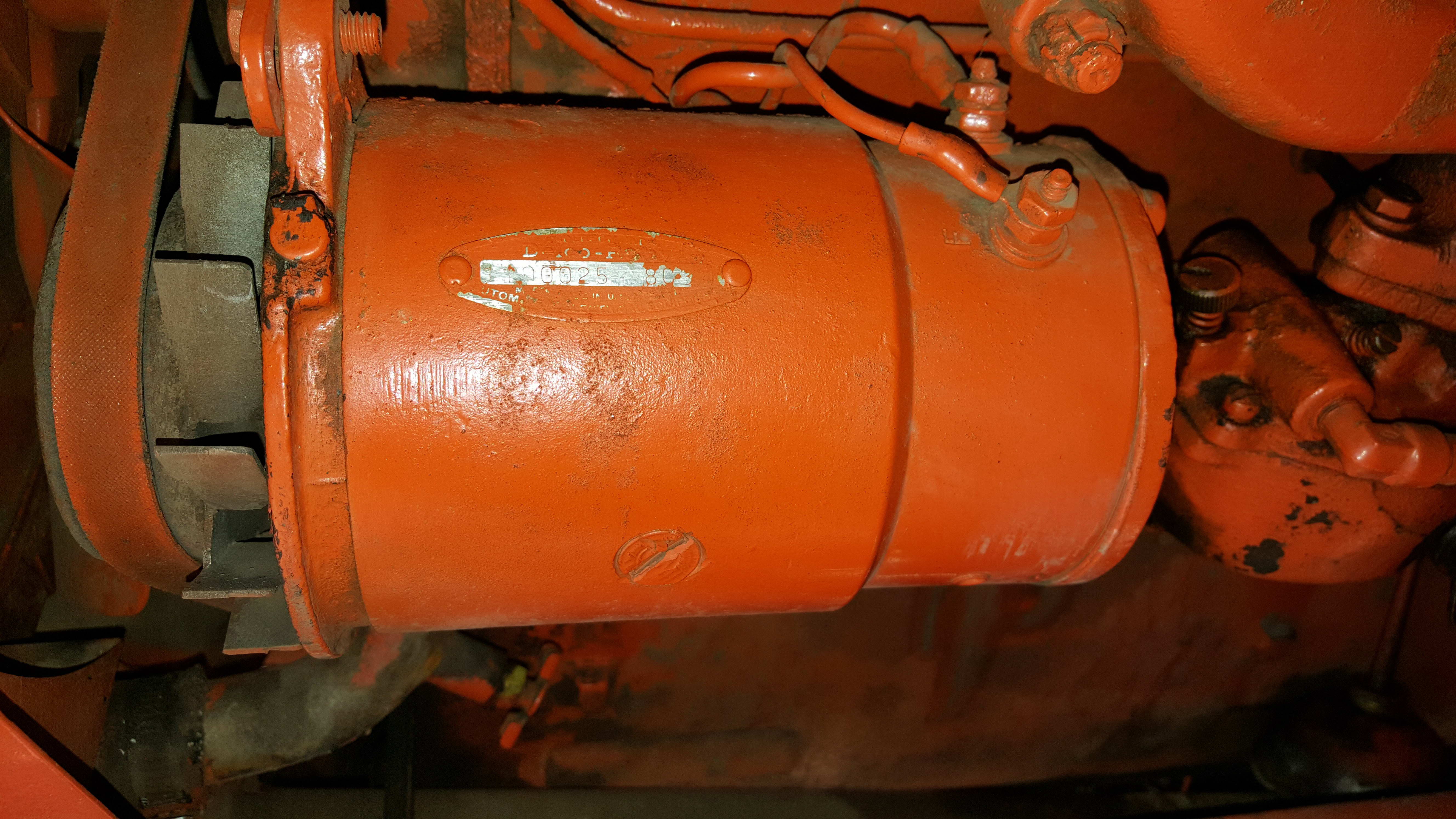

Joined: 24 Jun 2013
Points: 37
Post Options Post Options   Thanks (0) Thanks(0)   Quote brews4me Quote  Post ReplyReply Direct Link To This Post Posted: 15 Nov 2016 at 3:40pm
Ok, i'll give it a try, thanks so much!!!!
Can someone tell me how to test this generator and what type of measurement should be coming out???
You gotta love the person who was trying to help an old tractor out and painted every damn wire and part!!!!!! arughhhhhhhh but it runs better with an orange belt!!!! hahahahha
Edited by brews4me - 15 Nov 2016 at 4:07pm
Gerald J. View Drop Down
Location: Hamilton Co, IA
Points: 5636
Post Options Post Options   Thanks (0) Thanks(0)   Quote Gerald J. Quote  Post ReplyReply Direct Link To This Post Posted: 15 Nov 2016 at 5:09pm
It should show charge on the ammeter if its charging after starting if the engine is running at a fast idle or faster. If it has a voltage regulator that charging current should taper with time down to zero current. The A terminal should have 7.2 volts if regulated properly when its charging. It should be flashed if the battery has been changed, and that flashing should be before its run. To flash it should be in the manual, basically temporarily connect the B and A terminals on the cutout or regulator.
One test that also accomplishes flashing is to take the belt off and connect those A and B terminals. The generator should run like a motor. If you then ground the F terminal it should slow down.
Gerald J.

Points: 12043
Post Options Post Options   Thanks (0) Thanks(0)   Quote Steve in NJ Quote  Post ReplyReply Direct Link To This Post Posted: 15 Nov 2016 at 5:44pm
Someone did ask to check what Battery was in it. Me. So now we know its a 6V Battery. What's the Generator number on the tag. I can't make it out. The Delco 12V coil (112) is the 1.8 Ohm Universal version. Wrong for the application. Find out what the number of the Gennie is. It could be either a 6V or 12V with the short "step down" chassis. Also, to find out if it works, take it off and bring it to a rebuilder and let him load test it. He'll be able to tell you what it is and isn't doing. Check the voltage regulator. If its the OEM regulator (Delco) it will have its part number stamped on the mounting flange. If its been replaced, (which it probably has in its lifetime on the machine) unbolt it and look on the bottom of the unit. It will either be stamped, decaled, or inked what it is. ( ie- 6VPG, 12VPG/NG etc.) or have "VR-XXX number. I can ID that with my books.  You may have peaches and apples there. You want either all peaches, or all apples.
Steve@B&B

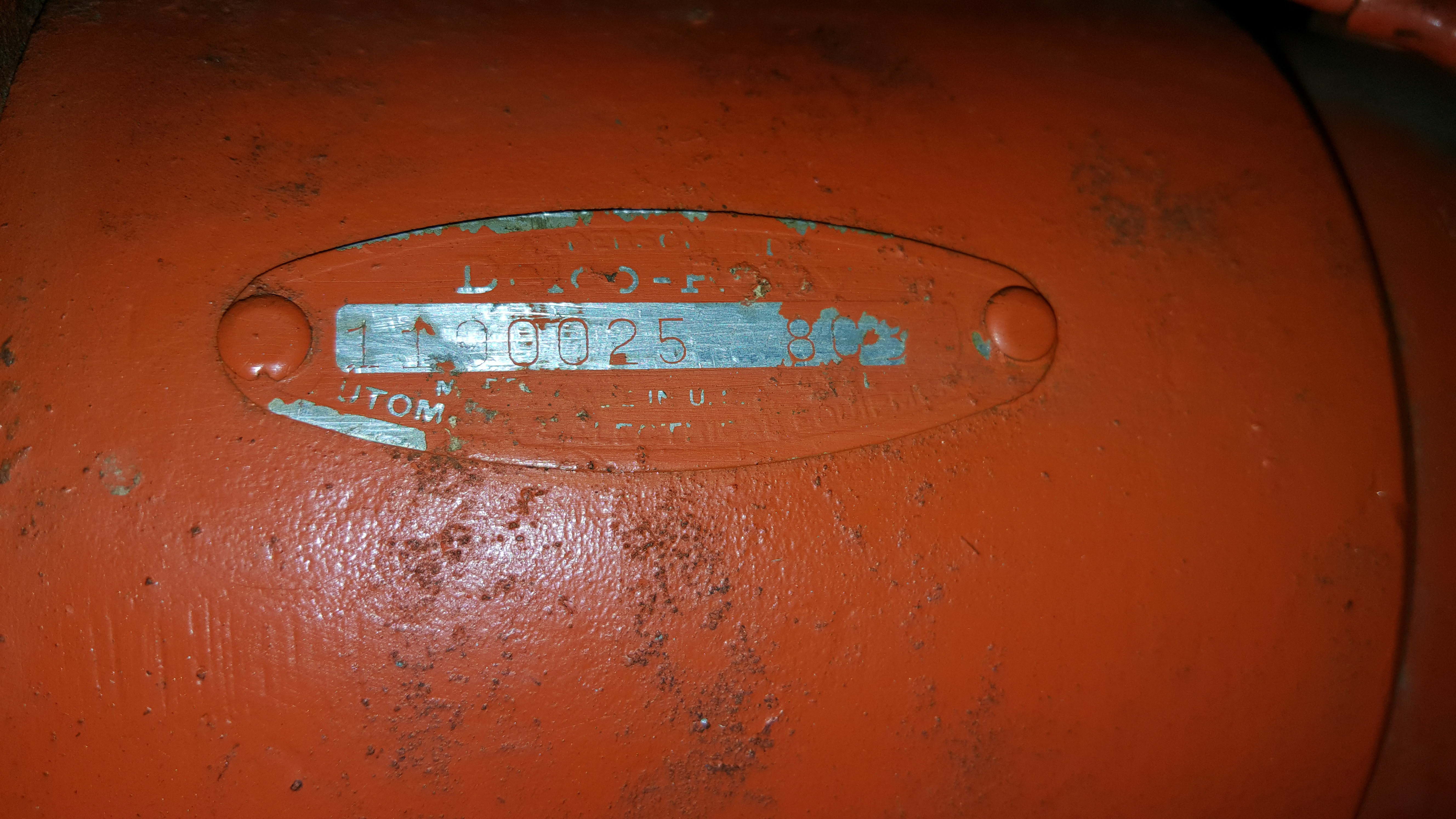

Gen, i took this pict last week also
Points: 5636
Post Options Post Options   Thanks (0) Thanks(0)   Quote Gerald J. Quote  Post ReplyReply Direct Link To This Post Posted: 15 Nov 2016 at 8:27pm
After its been tested be absolutely certain to flash it when reinstalling it. The odds are it will be the wrong polarity and that's disastrous to the cutout section of the voltage regulator.
There should be at least three terminals on the voltage regulator marked F, A, and B. F for the generator field, A for the generator armature, and B for the wire to the battery through the ammeter. There can be an L terminal used to allow operating lights only when the engine is running.
Gerald J.
Points: 12043
Post Options Post Options   Thanks (0) Thanks(0)   Quote Steve in NJ Quote  Post ReplyReply Direct Link To This Post Posted: 15 Nov 2016 at 9:21pm
Okay, the 1100025 is the higher amp 6V unit.  Max amps is 30-35 @ full field. Like I mentioned, I'd pull it off and take down to your local rebuilder if you have one and have him check it out. It also would be good to bring the VR with you also. So far you're six volts except for the coil. Pick yourself up a 6V coil. You still need to ID the VR yet.
Steve@B&B
Chalmersbob View Drop Down
Location: Pennsylvania
Points: 2122
Post Options Post Options   Thanks (0) Thanks(0)   Quote Chalmersbob Quote  Post ReplyReply Direct Link To This Post Posted: 15 Nov 2016 at 9:26pm
To check if the genny is working, after flashing it, ground the F wire. Your amp meter should show 10 amps or more. Bob
