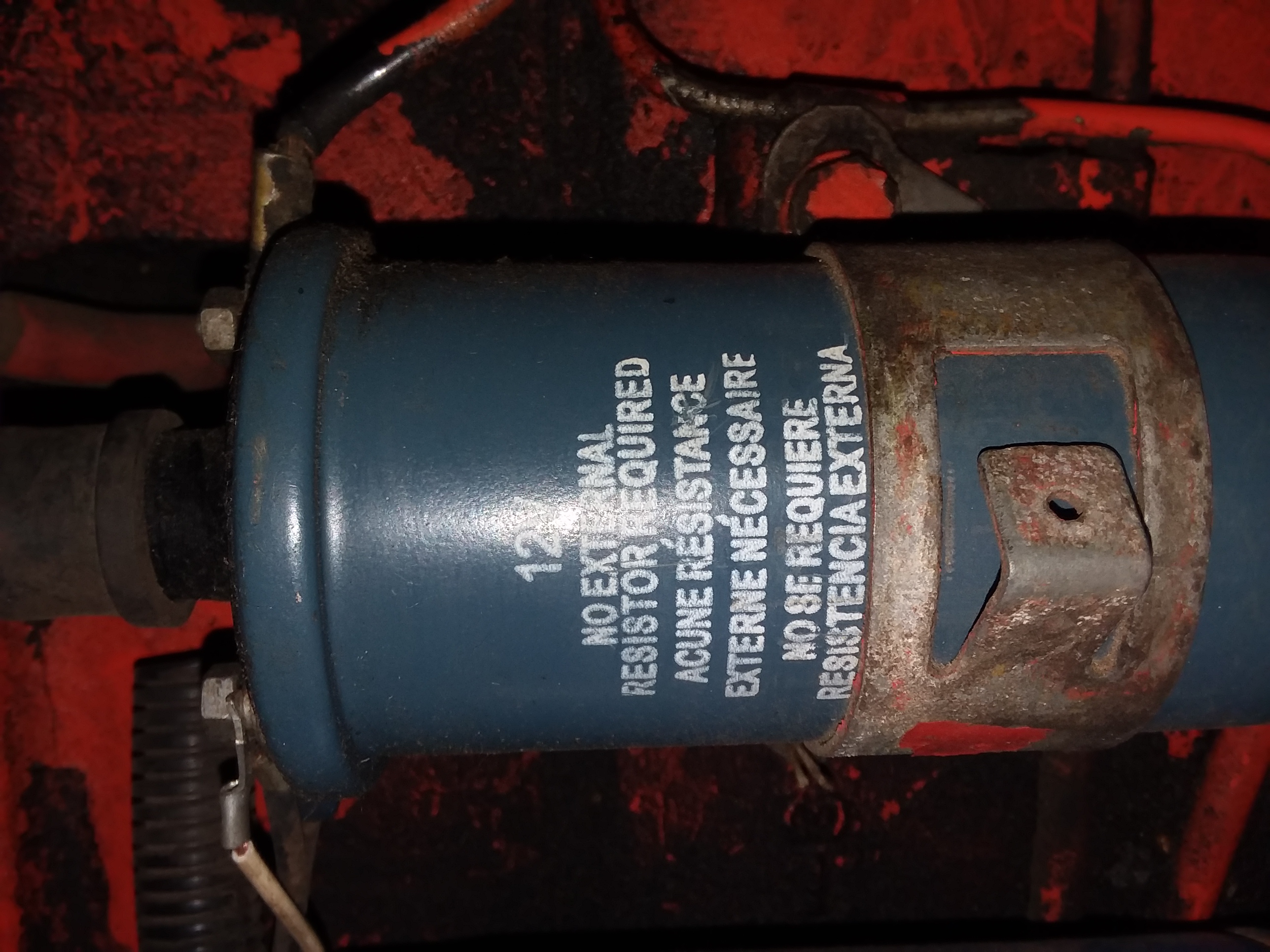

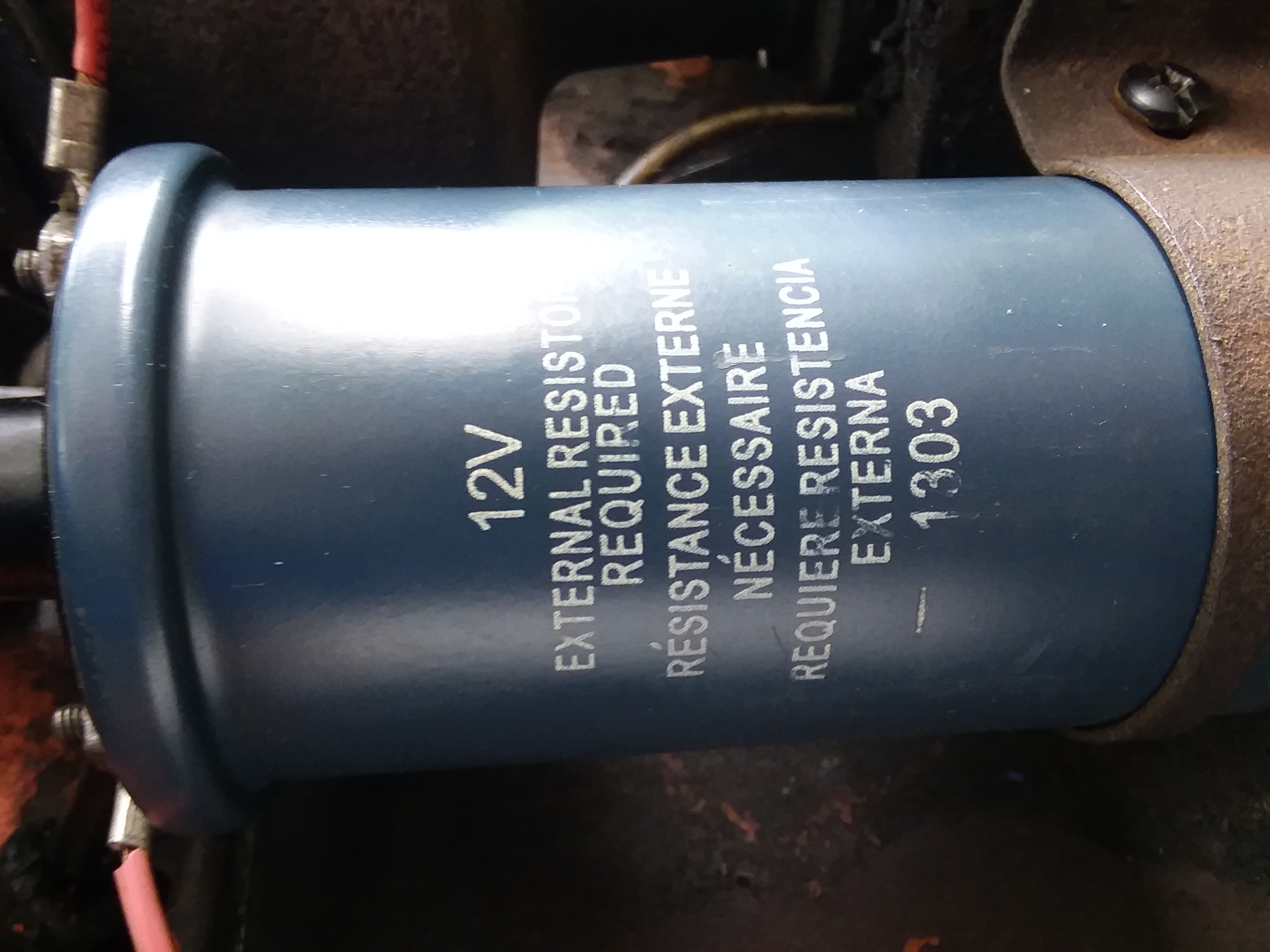

Post Options Post Options   Thanks (0) Thanks(0)   Quote danr Quote  Post ReplyReply Direct Link To This Post Posted: 26 Jun 2020 at 9:58am
I was out messing with a couple of my WD that are both 12 volt electrical systems. One has a coil that says 12 volt external resistor required. The other one says 12 volt no external resistor required.
Both run well.
I attached pictures of both coils but not sure they came through correctly.
Your thoughts?

Post Options Post Options   Thanks (0) Thanks(0)   Quote Dusty MI Quote  Post ReplyReply Direct Link To This Post Posted: 26 Jun 2020 at 11:25am
External resistor coils, were put on vehicles that the ignition started on 12 volts and ran on 6 volts.
Coils without resistors started and ran on 12 volts.
Supposedly the ones with resistors started easier.
All WD's came with 6 volt systems.
Dusty
