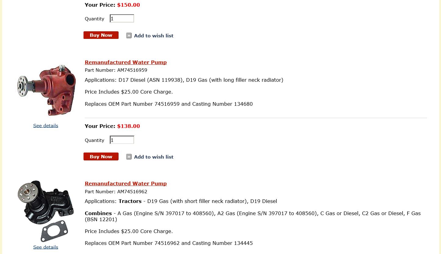

Would that be the late D17 Diesel? The early one was in the head same as the cockshutt one which there in no provision for on this engine. I am still wondering if there are any distinguishing features other than the big carburetor which determines this is a 262 and not a 230?
Regards
Neil

I think I may be understanding the water pump now. Looks like I need the first water pump and the second one I what I have now?

Yes the water pump you likely need is for a late D-17 diesel (Series III or IV) with the waterpump in the block. My mechanic just finished installing a late engine into a series I D-17D. We used a Gleaner 262 block and ran into the high fan water pump problem with the combine water pump. Years ago I had the wrong water pump sent for my D-17 IV diesel resulting in the same problem.
