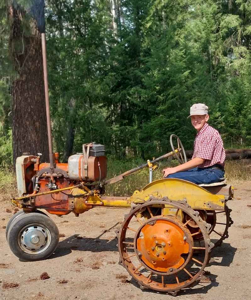

Grandson taking the tractor for a test drive

Post Options Post Options   Thanks (0) Thanks(0)   Quote 8070nc Quote  Post ReplyReply Direct Link To This Post Posted: 31 Aug 2025 at 6:52pm
Theres something about saving a old tractor or other equipment that gives a special satisfaction. A big smile on a grandchilds face is priceless. Battle scars and broken parts from mistakes or whatever are part of the process.
Good work

Post Options Post Options   Thanks (0) Thanks(0)   Quote Brian G.  NY Quote  Post ReplyReply Direct Link To This Post Posted: 31 Aug 2025 at 7:55pm
The only person who doesn't make mistakes is the person who never does anything.
I don't care what direction your grandson goes off in; he will always remember this event as a happy moment in his life!

Post Options Post Options   Thanks (0) Thanks(0)   Quote wjohn Quote  Post ReplyReply Direct Link To This Post Posted: 31 Aug 2025 at 9:49pm
Watch out for tree branches with that exhaust pipe LOL
Pretty cool to see it out and about.
Yup!
The exhaust manifold has a short stub welded on it so I simply plunked the extension on it from the combine engine. Not a good long-term solution in our timberland Big smile
