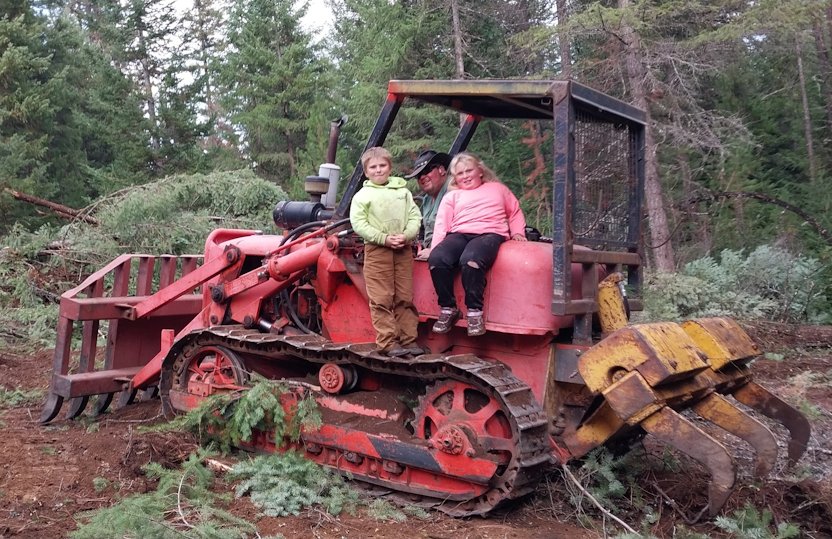

Son-in-law clearing land to open up a new gravel pit using his HD5G with the ripper I installed for him.

This ripper was originally for a Case 1050 machine, we estimate it to weigh ~2000 lbs so it should provide adequate counterweight for the loader. Son-in-law purchased the proper ripper mount for the HD5G from General Gear in Boise, Idaho, he also got the canopy from them.
I fabricated the ripper drawbar assembly to tie the ripper mounting plate to the drawbar pull point under the machine, and then fabricated the cylinder mount on the ripper (the cylinder came with the HD5G mounting plate). I made a 1/2 scale cardboard cutout to test the geometry of the linkage to ensure adequate lift and drop dimensions.
I modified the canopy to fit this machine and built the mounts for it; this definitely paid off because SIL tested it when a tree he was pushing came backward and would have conked him on the noggin without the canopy there for protection.

Pushing brush is a dangerous task. You have to watch for stuff "loading up" getting ready to come flying your way. Would be even better if you could have structure going fwd from cab and down to nose.

Might want to think about putting expanded metal all around that operator area except for the very front like said you or someone else pushing brush it’s very dangerous
I’m running a D7 with a KG blade and can’t say how many times that metal around the operator area has saved me from injury
After I cut the area we’re clearing my wife and I will put the root rake on to pile the brush and trees and if there’s still leaves on what your piling it’s very hard to see if something is being stressed that might spring back and injure someone

Excellent counterweight for that loader, they can be very tipsy otherwise, a full bucket of gravel is very heavy.

with the single grouser pads your track is going to suffer more wear when turning tp load . My 5G is using standard loader pads and I welded on rebar to forward and rear  pad crossbar (pad) several years back and it still is holding up great .

With that in mind, my Son-in-law pushes up a big pile of material and then positions the loader such that he only goes straight into the pile to scoop up a bucket load, then backs up. We then pull ahead with the truck, he scoots ahead to dump into the truck, the truck then pulls ahead so he can scoop up another bucket, we back the truck under the bucket and he dumps the second scoop. This fills these little F-350's as heavy as we care to be loaded so we then go dump and come back for another round.
As you may guess, this isn't exactly your modern, high production operation Wink But my Daughter is finally getting her muddy drive way fixed.

I fully support the rebar idea that Coke mentions. I did this (made up a jig) to a Cat 931 wide pad machine. The undercarriage shop mocked my idea but 15 years later pads and bars were still in great shape. The owner of the rebar outlet told me to get 'weldable rebar', I had never heard that term before because it seems that any rebar will take a weld. To do this 'rebar addition' to wide grouser pads is a good idea because of the increased width, the pads tend to become slightly rounded after years of use, the extra bar gives good re-enforcement.

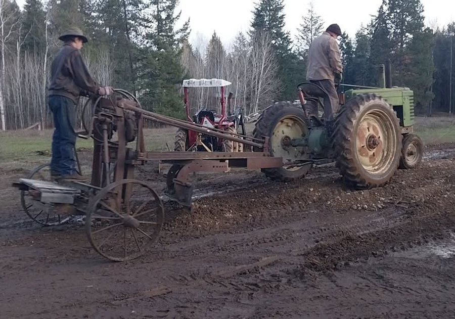

Once the gravel is dumped we need to spread it out.

Gotta love the grader with the hand controls. Who needs hydraulics!!

And not much electricity either, the only electrical device on that tractor is the magneto. It is a 1941 hand-start Model A. The grader is an Adams Model 21 Leaning Wheel Grader.
This is the first time I ever pulled it, in years past I was always on the grader, but it is time to pass the torch on to my Grandson. My old bones don't much care for the jolting any more.
