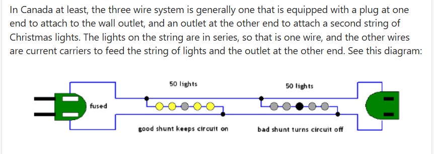

Joe, the NEW LIGHTS are wired something like this.. TWO of the wires are the HOT and NEUTRAL that go from one end to the other... The THIRD wire is a jumper between the other two that has a group of light bulbs in series... If you had 10 bulbs on the jumper then each one gets 120v / 10 = 12 volts... if you had 4 bulbs on the jumper then each one gets 120v / 4 = 30v... etc...(NOTE:--- voltage between the ORIGINAL 2 wires is always 120V).. If you cut the 3 wires at some point , SOME of the light strings will continue to work as the bulbs still have a HOT and NEUTRAL... However there are some FLASLHING Lights that have a diode / resistor type setup on the FAR END PLUG, and if you cut that off, the NOTHING works.. All you could do is cut a wire and then plug back in and see if half your lights still work.. a test...
The BEST solution is the old 2 wire system where all bulbs are in PARALLEL as WF has posted..

No, just NO.
Will be a small box near the plug, that is where the voltage control is(Electronic) to produce the lower voltage for LEDs, is designed for 100 and will release the magic smoke any other value beyond one or two burn't out.
