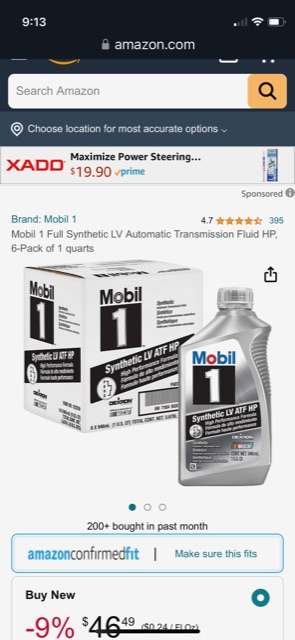

Post Options Post Options   Thanks (0) Thanks(0)   Quote AveryD12 Quote  Post ReplyReply Direct Link To This Post Posted: 01 Oct 2023 at 7:28am
Codger,
Trying my luck at uploading a picture. Just to be sure this is the correct fluid?
Thanks
Avery

Yes, that is correct. I could not find the correct transmission filter online so went with Napa. There are two or three filter options so snap a photo of your transmission pan to have with you.

I thought the blue label fluid was the newest type.

My wife poured hours into researching this and found the black to be the latest. I can't quote her resource but that trans gave us fits in a 2017 1/2 ton.
I need to clarify this a bit after speaking with my wife.
The blue label product is actually newer than the black label product but is not the best to use in a truck that is worked. The black label product tended to absorb moisture with short runs or very limited use. The blue lable product has an additive package to counter this, but In reality does not remain with use and needs renewed, (changed) routinely. From her understanding the black lable fluid is better overall.
If you use the truck and get the fluids up to temperature routinely, absorption would not be an issue, but if it sets for extended durations, it "could" be an area of concern.
Sorry for the confusion.
