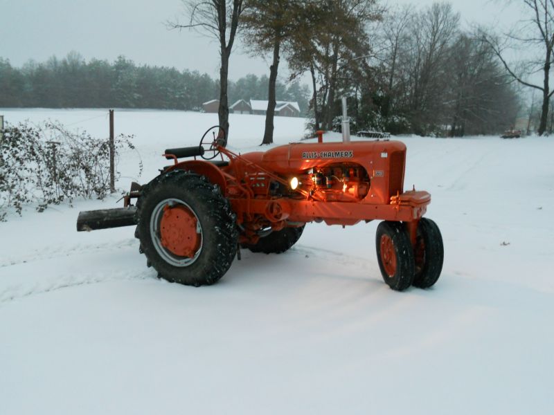

Hey folks, its been a while.  I finished my WD in 2009, and it has been on parade duty and used to ride around the field some since then.  I put an engine from a Gleaner model E in it, and used the generator.  It will only charge at pretty high rpm, which is not ideal for parades.  I'm thinking about putting an alternator on it, hoping for more reliable charging.  I don't want a big delco hanging off the side of the radiator shroud.  Any hints on a suitable compact one wire alternator?
This was a few years ago, but I know we all like pics!

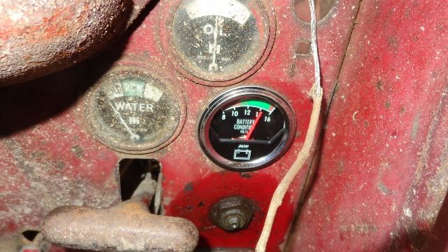

I think they shop said the nippodenso was about 30 amp.  In the application below I was able to use the same pulley that came on the new alternator. I did change to a volt meter (was a ampmeter) and moved over to a positive ground system too. Of course a new bracket was needed to support and align the alternator, along with revised belt tension bracket. Still well worth the effort.
Some shots of the change over on a 1952 IH TD6
Gerald J. View Drop Down
Location: Hamilton Co, IA
Points: 5636
Post Options Post Options   Thanks (0) Thanks(0)   Quote Gerald J. Quote  Post ReplyReply Direct Link To This Post Posted: 15 Dec 2016 at 9:39am
That voltmeter is simply decoration, the ammeter tells you more but is a bit messier to install needing bigger wires for the alternator. A voltmeter can tell you there is enough voltage in the system (where ever it is connected) to charge the battery but won't show if the battery is connected good enough to take a charge or crank the engine. A good voltmeter needs to have at least 0.1 volt resolution and be connected directly to the battery, but then with ignition switch off it will run the battery down.
I doubt you can run that alternator with positive ground, it should be negative ground the SAE standard since about 1963.

Gerald,
You are correct I changed this to negative ground. My mistake.
Volt meter vs amp meter?  I am not a electrician! This system seems to work for me. Have not had any dead batteries yet. But depending on how long I live, there may still be time.

Why in the world would a company make a volt meter that would intentionally run the battery down? That just doesn't seem right!

Post Options Post Options   Thanks (0) Thanks(0)   Quote corbinstein Quote  Post ReplyReply Direct Link To This Post Posted: 15 Dec 2016 at 1:57pm
Actually most Alternators charge around 14.7 Volts.
And Most 12V batteries are fully charged around 12.3 or so Volts.
AND when discharged are somewhat lower, 11.3 or less...
So a Voltmeter if properly calibrated and placarded with tickmarks around these numbers will be helpful. In addition to an ammeter if possible. Also the Voltmeter should be on a switched source, not direct to the battery, as over time, it's possible that it will run down the battery.
Points: 12045
Post Options Post Options   Thanks (0) Thanks(0)   Quote Steve in NJ Quote  Post ReplyReply Direct Link To This Post Posted: 15 Dec 2016 at 2:23pm
Its not the Voltmeter that runs the Battery down. If an Alternator is hooked directly to the Battery, the Alternator can slowly steal millivolts from the Battery. If it sits long enough, it could eventually bring the Battery down low enough to where it won't have enough reserve in it to fire the engine. And again, a Voltmeter is much safer than an Ammeter when using an Alternator. The Voltmeter is as simple as the Tractor. All you need to know is the normal charging range for any 12V system is 13.9-14.5. Ideal is 14.2. Anything higher or lower than that range the system isn't charging (if lower) over charging (if higher) Pretty simple. With a small amp Alt, you could run a 60/60 sweep Ammeter to be in the safe zone if you wanted to stick with an Ammeter...

Post Options Post Options   Thanks (0) Thanks(0)   Quote Gerald J. Quote  Post ReplyReply Direct Link To This Post Posted: 15 Dec 2016 at 7:00pm
Good alternators charge at 14.200 volts. That is the charging voltage for a staring battery with full charge 1260 specific gravity. Such a standard battery connected to a voltage regulated source will draw as much current as the source can supply when it needs charging and is first connected to that source. As the internal battery voltage rises towards 14.200 the current goes down and when the specific gravity gets to 1260 from charging, the current tapers to ZERO. And by the ammeter indicates it is fully charged. To get that true information from a voltmeter that volt meter needs to be connected to the battery posts. It takes energy to make a rugged automotive voltmeter work, unlike the microamps for a Simpson 260 multimeter, but the 50 microamp meter movement of the 260 will not survive on a tractor, too much vibration and too much moisture. In the real world such a voltmeter connection would require a relay powered by the ignition circuit to connect and disconnect the voltmeter from the battery. Way more complex than good ammeter wiring.
The battery voltage does go down when disconnected from the charging source even with no load, typically down to about 12.6 volts in a few hours. Voltage drops as it is loaded and when most of the available energy has been delivered it gets down to about 11 volts and for the same load the voltage falls much faster than it did with more charge available.
The magnetic voltage regulator typical of 40s, 50s, and 60s vehicular and tractor electric systems by SAE standard was allowed a plus or minus 1/2 volt tolerance. A 1/2 volt low leads to a battery never fully charged and a half volt high caused much loss of water from the electrolyte and so lots of battery maintenance required. In time the SAE standard has required more precise voltage regulation easily achieved with solid state regulators (my first one I built about 1968 and it doubled battery life in that car) and standard with the internal regulators of the 10-SI and later Delco alternators.
A voltmeter is definitely easier to wire than an ammeter but I claim gives very little information. That car that I built the solid state regulator for (putting a 12 volt VW engine in a 6 volt car) had lab quality voltmeter and ammeter and the ammeter was much more informative before and after the engine swap.
That 14.200 volts is perfect for a battery at 68 degrees F, the perfect voltage rises as the battery temperature rises or falls. A good regulator may take that into account, mine did purely by accident.
Steve and I have disagreed on the lack of benefits of a voltmeter for many years.
The factory "voltmeter" in the dash of my '98 F150 has two calibration points, 10 and 18 volts, nothing in between. A pilot lamp or the dash lamps would give as much information.
There is nothing but diode mounting and wiring in an alternator that sets the polarity. It shouldn't be hard to make one for positive ground. Somewhere I have a Leece-Neville truck alternator that isn't grounded so it can be wired externally for either polarity.
Generally you'd put the voltmeter on the ignition switch. If you have a magneto you wire a switch anyway.
