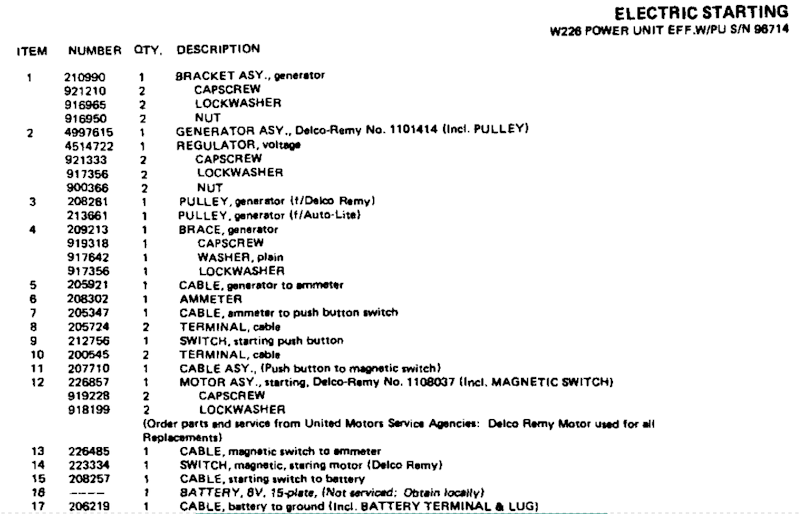

Actually, they work well enough that Allis-Chalmers offered it as standard equipment on the W226 Power Units.
It is a simple matter to adjust the Third-Brush type generators to properly charge an 8 Volt battery, my late Father-in-law ran his WD this way for decades with no ill effects.

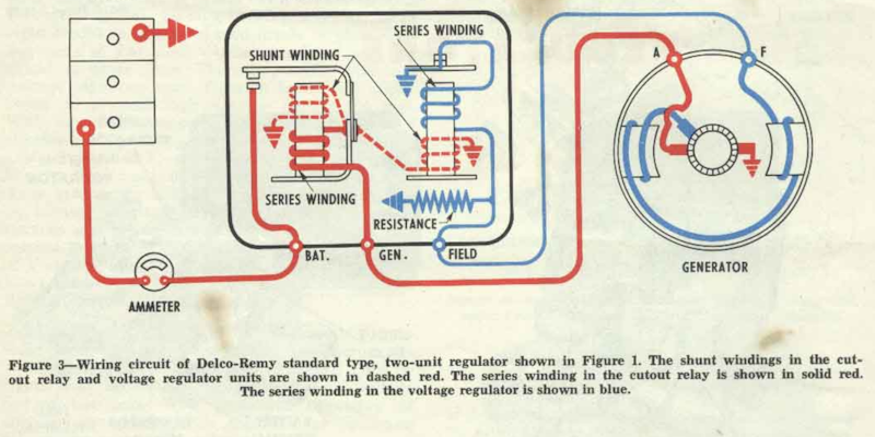

Originally posted by 55allis 55allis wrote:
If I’m understanding this correctly someone could run the old 6v cutout on a 12v battery without any issues? …
That may be pushing your luck a bit.
The 6V cutout has small diameter shunt windings that are used to energize the cutout relay which connects the generator output to the battery and thus the rest of the electrical system. These windings are designed to withstand a certain amount of current and also be able to dissipate the heat generated by this current.
Ohm's Law tells us that if you double the voltage across a fixed resistance you will get double the amount of current. Ohm's Law also tells us that Power (Watts) = Volts x Amps.
When both Amps and Resistance are known, the formula for Watts is P = I^2 x R.
If we double the amount of current through the shunt windings, we increase the Wattage by 4 times; this quadrupling of the heat generated in the windings MUST be dissipated somewhere, and if not, it may well burn out the windings.
I was unable to find a decent diagram of a 6 Volt cutout, but they look exactly like the cutout relay shown in the Shunt Winding shown in the dotted red lines below.
