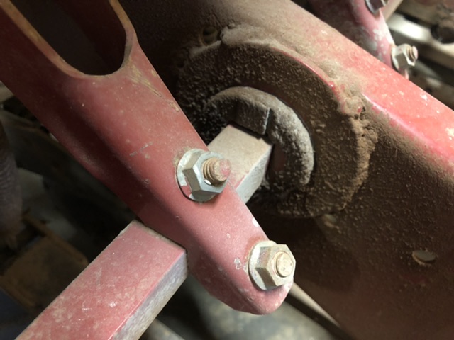

I always blow air though all the holes at a wide open setting. I had to rebuild the bushings in the front with steel ones that hold down pressure some years ago on that I believe 1 1/4” bar. The originals were plastic and wore out(bad design). If the machine is clean and adjusted correctly, they do a nice job.

Post Options Post Options   Thanks (0) Thanks(0)   Quote allisbred Quote  Post ReplyReply Direct Link To This Post Posted: 10 May 2020 at 7:16am

My first thought is something was plugged or ran out of grain. Second thought would be planting condition. Since the planters are semi independent, I would look at depth and soil compaction setting all the way back to the press wheels. I have had to adjust these to get the correct pressure. Those bushings wore out 25 years ago and replaced because everything for pressure started there.

Another critical point to look at, the lower control bar may have hopped off the front pivot point. I have knocked it off before and replaced some parts on (1) unit from hitting a rock in the field. You really only notice it when your in the field planting because when lifted, it falls back in place. That would cause a poor plant condition as well.
