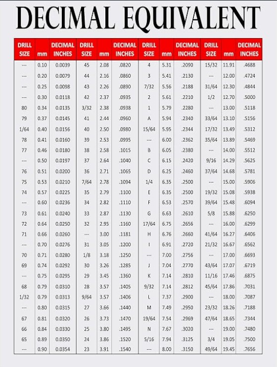

how are the jets numbered? the higher the number is the jet orifice larger or smaller?

'old school' it was the drill number that made the hole.
Points: 90804
Post Options Post Options   Thanks (0) Thanks(0)   Quote steve(ill) Quote  Post ReplyReply Direct Link To This Post Posted: 17 Jul 2025 at 7:31pm
yep... the NUMBER is the DRILL SIZE...
example--- a #44 is .086 inch hole..
