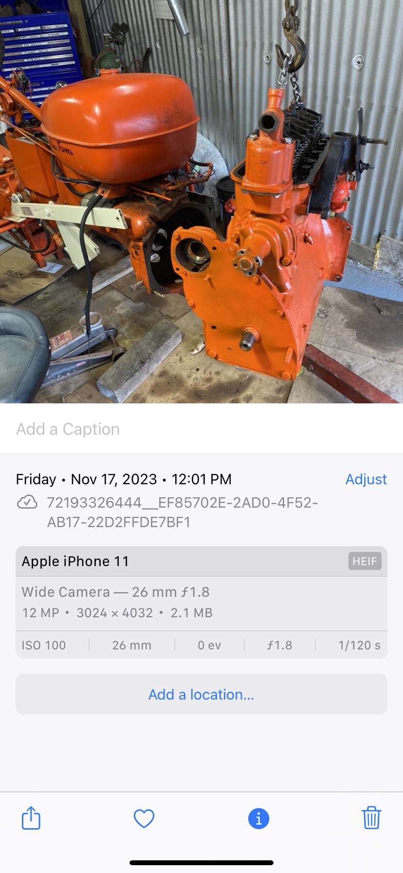

Ok guys n gals before I fire up the freshly rebuilt 125 every surge spring I’ve seen pulls it forward however the spring I have doesn’t appear correct so I’m wondering does the spring pull forward or should the spring pull towards the rear thank you. Dana

The right way is to hook the long end of the spring over the top manifold stud forward of center. Some have hooked it many other ways, all wrong.

Thank you!
