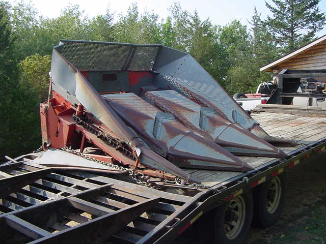

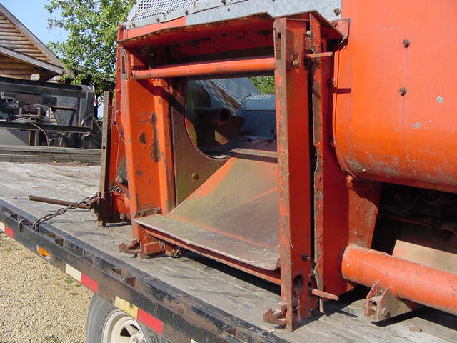

orangereborn View Drop Down
Location: NW WI
Points: 1491
Post Options Post Options   Thanks (0) Thanks(0)   Quote orangereborn Quote  Post ReplyReply Direct Link To This Post Posted: 11 Sep 2025 at 9:58am
This is what I have.  Was told it is a 330E with an "A" Adapter..  Make sense?  Dale
Points: 8640
Post Options Post Options   Thanks (0) Thanks(0)   Quote SteveM C/IL Quote  Post ReplyReply Direct Link To This Post Posted: 11 Sep 2025 at 1:22pm
Maybe made to fit an E but adapter makes it fit a wider A? I had a flat chain 330 on an A2.
