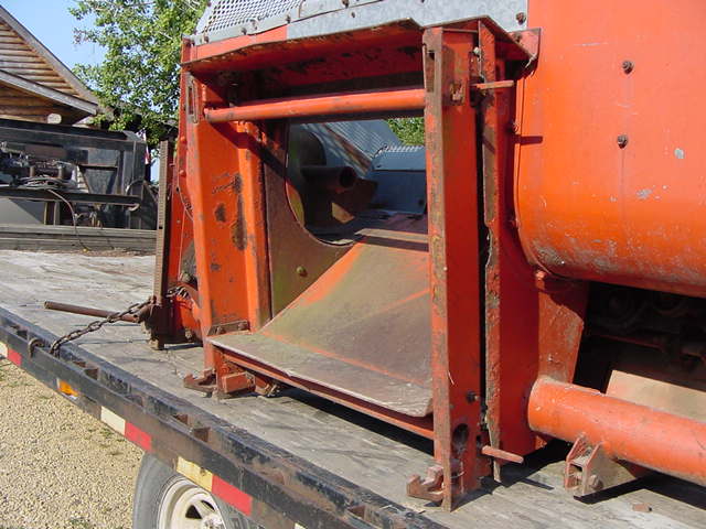

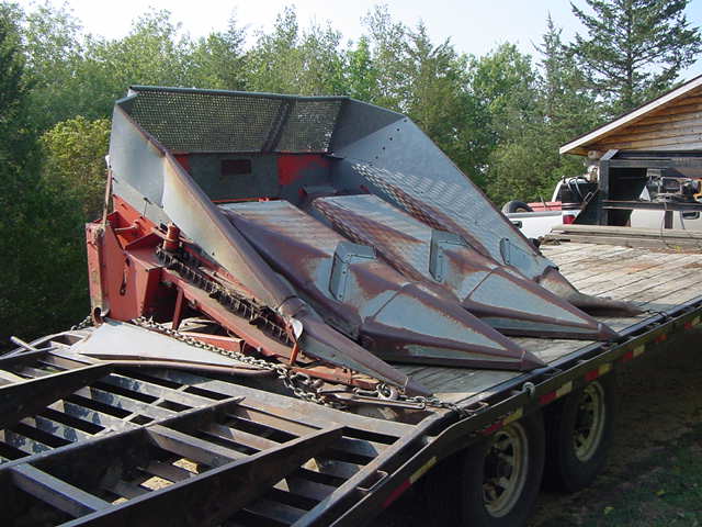

This is what I have.  Was told it is a 330E with an "A" Adapter..  Make sense?  Dale
Points: 8636
Post Options Post Options   Thanks (0) Thanks(0)   Quote SteveM C/IL Quote  Post ReplyReply Direct Link To This Post Posted: 7 hours 19 minutes ago at 1:22pm
Maybe made to fit an E but adapter makes it fit a wider A? I had a flat chain 330 on an A2.
