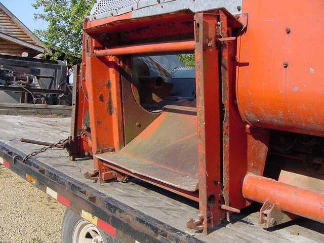

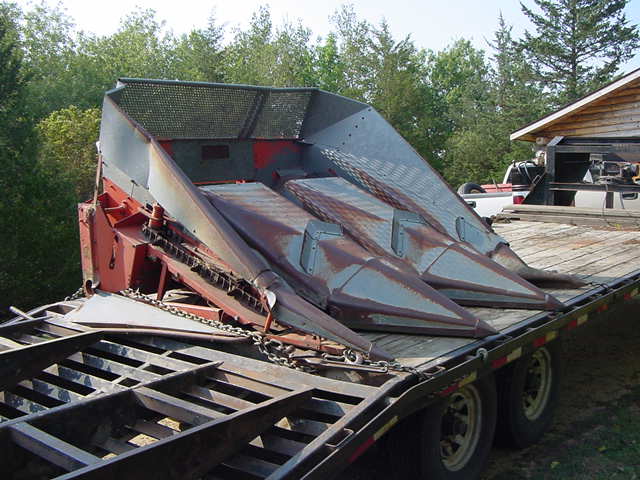

This is what I have.  Was told it is a 330E with an "A" Adapter..  Make sense?  Dale
