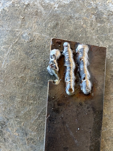

 DAVE KAMP,,,you devil,,,you,,,!!!!
  I HAVE A WELDER,,,!!!
 a little practice and I'll be stacking them dimes,,,,,!!!!
Points: 90812
Post Options Post Options   Thanks (0) Thanks(0)   Quote steve(ill) Quote  Post ReplyReply Direct Link To This Post Posted: 09 Dec 2023 at 9:48am

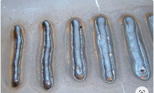

your bead is a little TALL Joe.. You need less wire feed or probably more AMPS to burn in more and get it to FLOW out to the sides.
BUT YOUR GETTING CLOSE !!  Clap
here is a photo i found on the Internet.. Starting at the LEFT with a weld at too LOW of amps... gradually UPPING the amps as he rewelds to the right... Of course with THIN material you got reduce the wire SPEED if you can not UP the AMPS..
