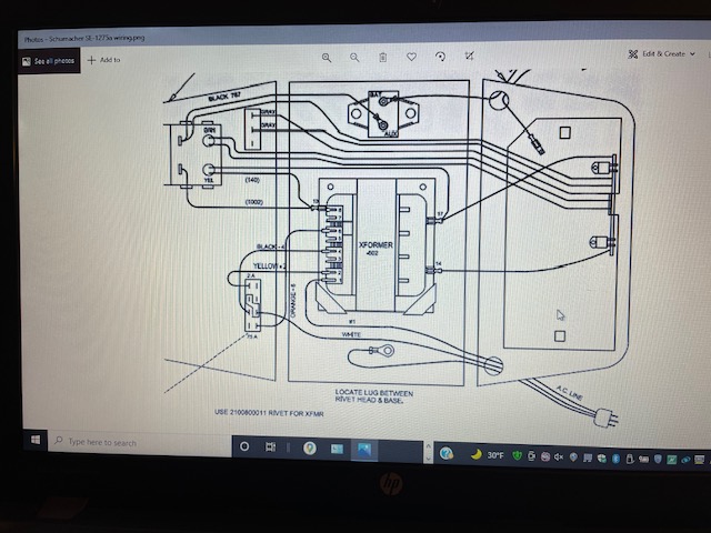

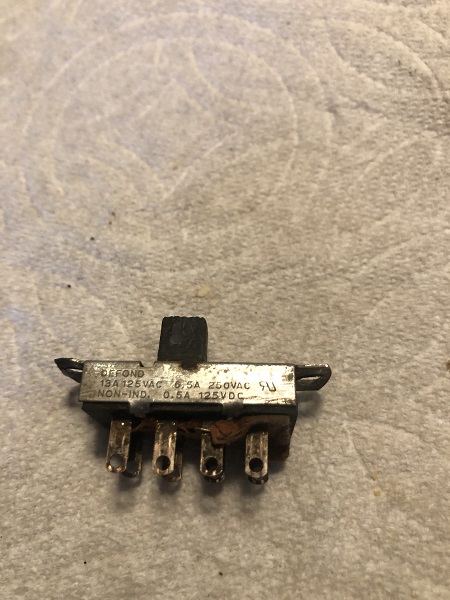

  I plugged it in and sure enough it did not work, so I open it up and there were two wires dangling inside and after a long search,,I finally fount the correct wiring diagram and found where the wires went,,,plugged it in again,,,and,,,,and,,,IT WORKED!!!!! Glad I didn't listen to that little Dude on my shoulder that tried to talk me into throwing it away,,,,,,BUT,,,one of the wires that had come loose,, did so because the 8 pin slider switch had real loose pins and one of the pins had the main 12 VDC incoming on one of the pins. I opened up the switch and the slider contacts were corroded and loose in the housing SO ,,I looked in Surplus Supply, Ebay, Amazon and do not find a switch exactly like this as this one has a brass strip on the back shaped like a "Z" that ties two of the contacts together from one row of the 4 to the other row,,,,clear as mud,,,??? This one has two rows of 4 pins and one of the pins on the "Z" has the incoming 115 VAC tied to it. I've looked at a gazillion switches and nary a one has that brass strip tying two pins on opposing rows.
Possibitity of making a "12 ga wire jumper"  to tie the two pins together if the proper switch can't be found??

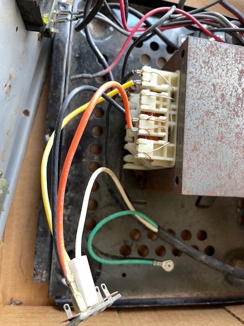

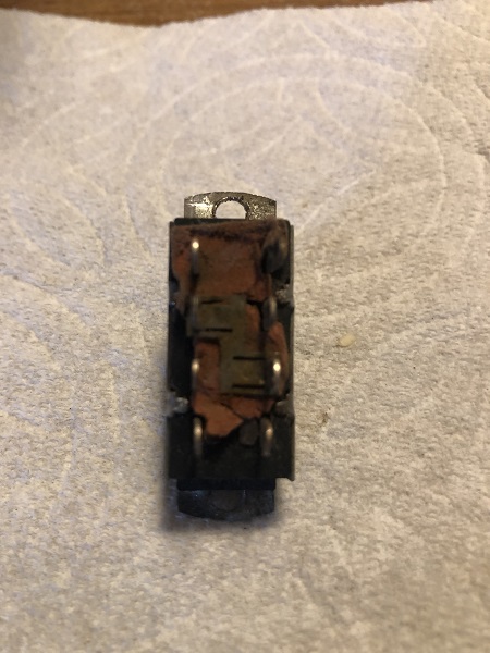

 It is a Diehard Model 200.71222. I did re-assemble it and it did charge  on the low (2 amp) setting and the middle (10 amp) setting but would not do anything on the 50 amp setting until I jiggled the switch but don't want to leave it like that. I took some pics ,,see if I can post em,,,,,

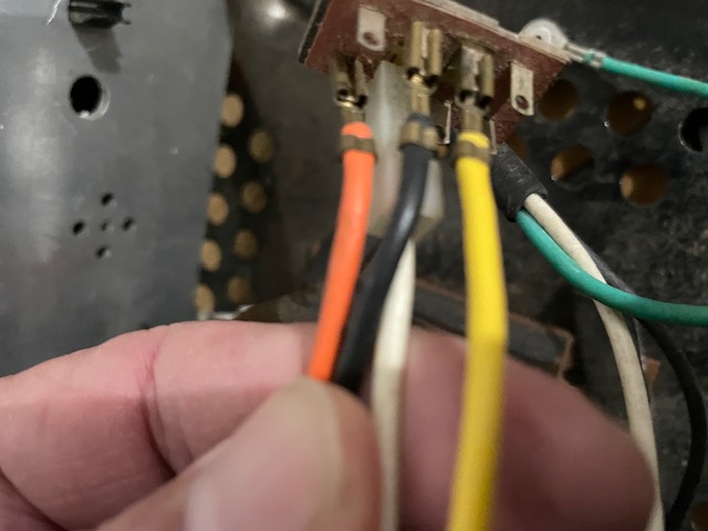

 Chit,,it kinda hard to see the brass Z that ties the #3 pin on right side to the #2 pin on left side,,,
 Just so I know,,,on this multiple pin type switch,,,"Do the pins on right side have continuity with the pins on left side,,,???

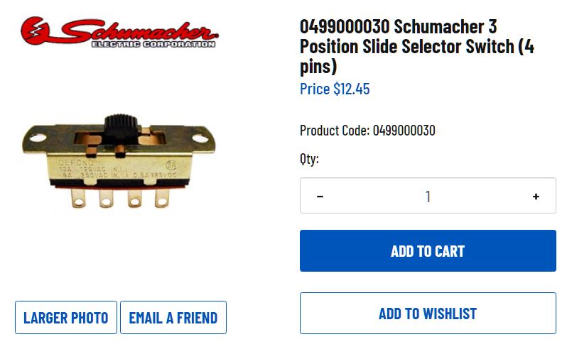

If you GOOGLE  "Schumaker 3 position slide switch" ... you will see it... I believe most vendors have it as DISCONTINUE..... This is the WRONG SWITCH... only 4 terminals...

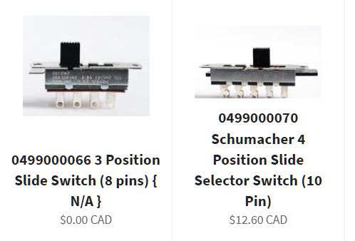

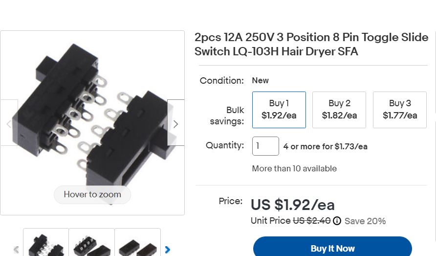

YIKES.... that is a 4 pins switch, you wanted a 8 pin.... Not as many available anymore.. Lots are 3 or 5 amp.... Make sure you get a 12 or 13 amp switch !!.... something like this.

I looked at the ACRC site and the 8 pin switch is no longer availabe ( as also seen on several other sites)... they do have a 10 pin switch with 4 positions you could use.. might have to move a small mounting screw hole and not use 1 position.......... or you can use the BLACK switch i show above... It is used in electric hair dryers and other appliances.... but i dont see any mounting screw holes on it.

Post Options Post Options   Thanks (0) Thanks(0)   Quote jaybmiller Quote  Post ReplyReply Direct Link To This Post Posted: 18 Apr 2022 at 6:40am
Man that's one 'sad' switch....
If you number the pins like this
1   5
2   6
3   7
4   8
the 'Z strip' is a jumper that connects pins #2 and #7 together. unless it was soldered in place, it could be a 'problem'.
The 4 pos sw could be used, just do NOT use the 2 'extra' pins.
I sure hope you took pictures/wrote down which colour wire went where.......

Post Options Post Options   Thanks (0) Thanks(0)   Quote jaybmiller Quote  Post ReplyReply Direct Link To This Post Posted: 18 Apr 2022 at 10:24am
no that switch will not work.....poof !!
The charger switch works as follows
1st position, 1--2 , 5--6 are connected
2nd position, 2--3 , 6--7 are connected
3rd position, 3--4 , 7--8 are connected
the Z strip ALWAYS has 2 connected to 7
clear as mud, right ?
You really need a DP3P slide switch.... Double pole, 3 positions.

same part number, different dealer ( wrong photo)... Phone in upper left corner.
