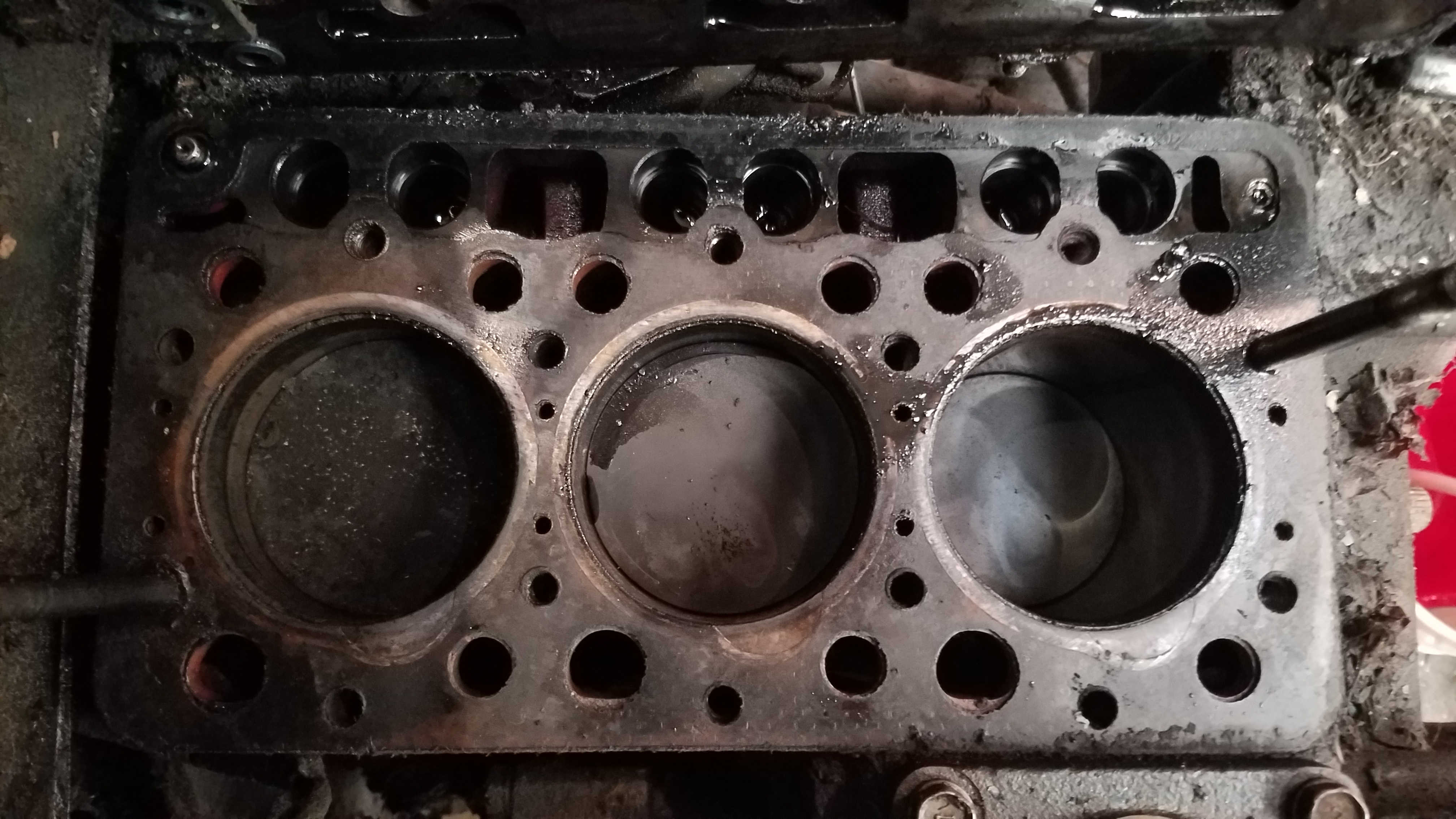

So I ended up pulling the head on the tractor to inspect the  head gasket as that was the only thing I could think of apart from bad rings. Head gasket was good. Cylinder #1 was clean and from what I could tell looked like it was burning fuel correctly. Cylinder #2 was dirty and had a "chip" out of the edge of the piston head. Cylinder #3 was filthy. Probably zero fuel being burned in that chamber. Looks like new rings and a piston I guess.

Points: 54745
Post Options Post Options   Thanks (0) Thanks(0)   Quote DiyDave Quote  Post ReplyReply Direct Link To This Post Posted: 22 Nov 2016 at 5:47pm
When you put it back together, don't lose the oil pipe seal ring, that comes with the HG...
