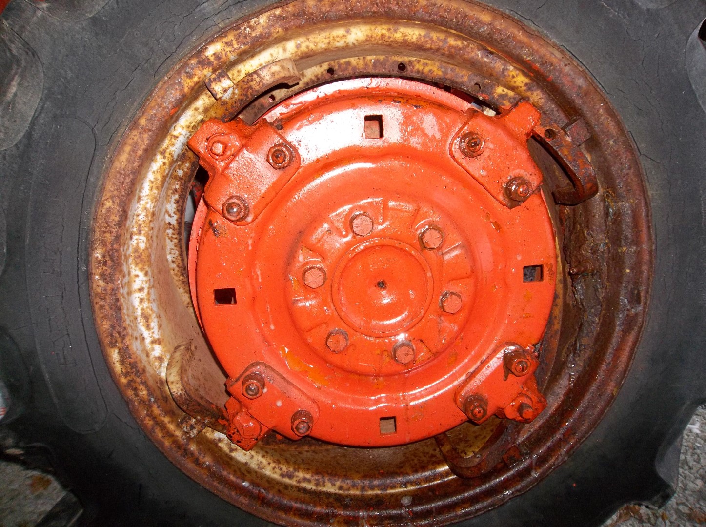

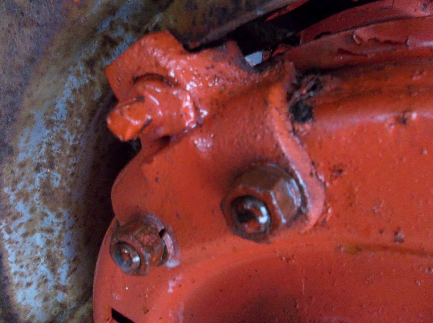

I'm not sure what these are called, but should only three of them have the square head locks for the spin-out rims or should all four? I only have three of the square heads on each side so wondering if someone broke them off or if it is supposed to be like that?
I got all the wheel bolts loose but never attempted those square heads yet. One is broke off but you can still see part of it.
Can any of these still be bought new or do I have to find salvage if I can't get those square heads out?
The rims and center hubs are worse than I thought too. But I know I can get new rims. Not sure about the centers though either.

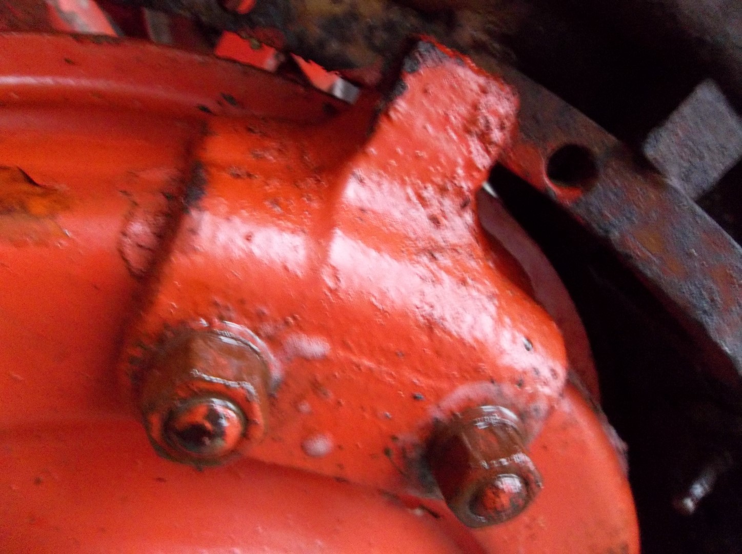

Here is the one that has no square head. It is the same on both rear rims. Is this right?

Right or wrong, my CA is the same way.

Mine has the same setup and my eccentrics are froze and will not loosen up grr. Randy

Oh OK. Maybe there are only three of the four that are supposed to have the heads then.
I wasn't sure if maybe somebody broke them off.
I looked at all the stop bodies that are listed on Steiner's, Oklahoma Tractor and Yesterday's Tractor but none of them look like what I have.

They only have 3 and a blank.

Only three have a X entries one is a blank. You put that one on first. The other three have a square piece with a cutout that sits against the excentric bolt. Don't loose the little rub block when you take it apart. On one of my tractors I had to take all the bolts out that hold them to the wheel center lay the assembly flat on the ground and beat the center out of the rim. Once out it was fairly easy to loosten them up in the vise with a torch hammer and wrench.

CA, D10, & D12 only has three eccentrics.  I took the two bolts out that hold the clamp to the center and slide back on the rail so I could remove the clamp from the rail.  You will need to tap the bolts with nuts loose so you can get the bolts out.  This allows your to tap with hammer so you don't damage the threads.  After removing bolts you may have to tap the clamp to slide it back on the rail far enough to work the clamp out with your hands.  Remove one clamp, freed the pin and put back in before you do no. 2 & 3.  To loosen the eccentric pin soak with penetrating oil. Remove wire snap ring so you can tap with hammer back an forth until pin comes out.  Polish off all the rust and when clean resemble with anti seize.
