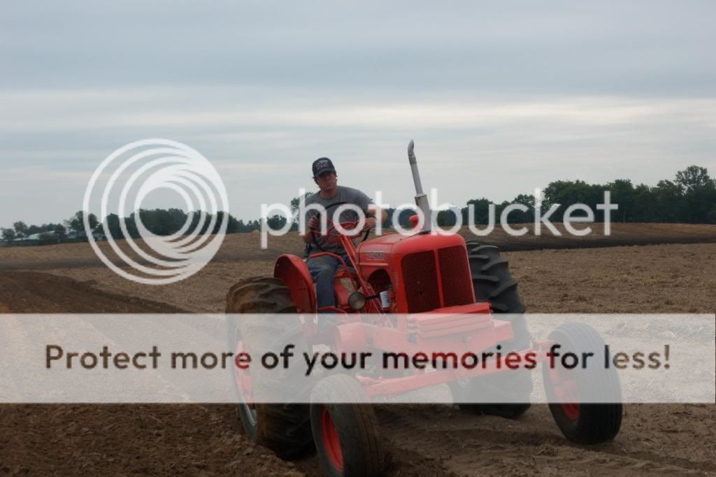

I had the same problem after I painted my WD45. Sometimes starting, I'd get a little blown out and deflect down on the hood. I went to NAPA and bought a 90 degree exhaust pipe and cut it to blow off to the side. no more soot.

Nice lookin 45 there Dave, big rears and especially those big multi-ribs on the front really set her off.
