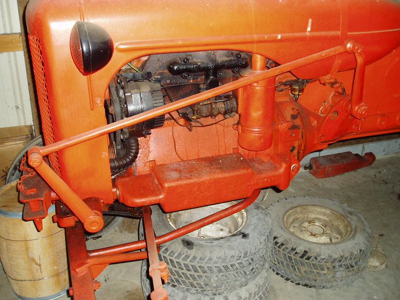

CA side weights:

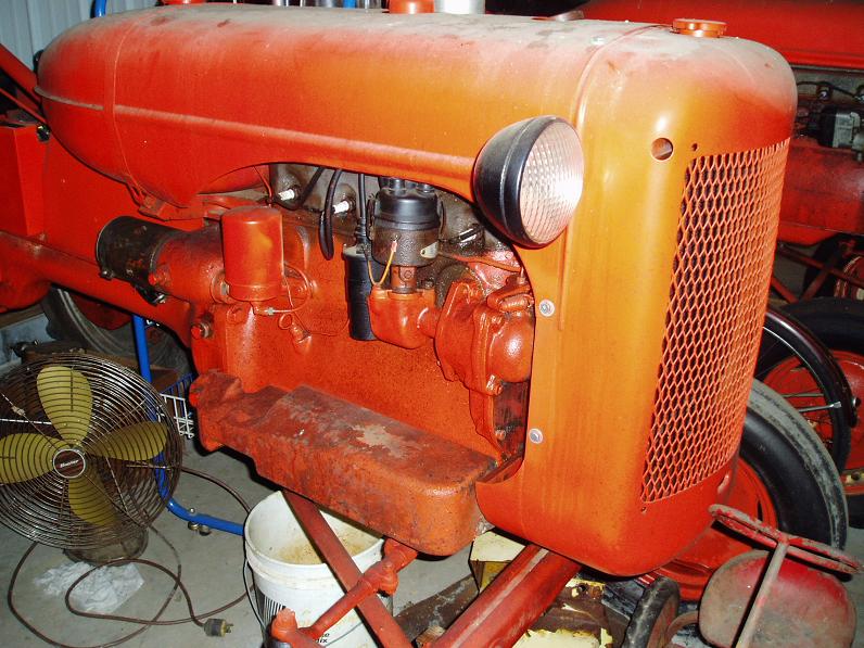

B side weights:

Will the engine side weights from a CA work on a B? I need to borrow a set but want to make sure they will bolt up. My initial thought is no as it seems I recall the CA having little nubs on the engine for this.
